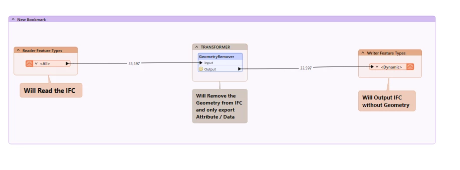

I have very big IFC file in GB, what i  would like to do is just keep Attributes and export it as IFC file without loosing any order or level etc.
Only remove Geometry , below is what i am doing but not getting it right . Any support would be highly appreciated.

Here is FME workbench

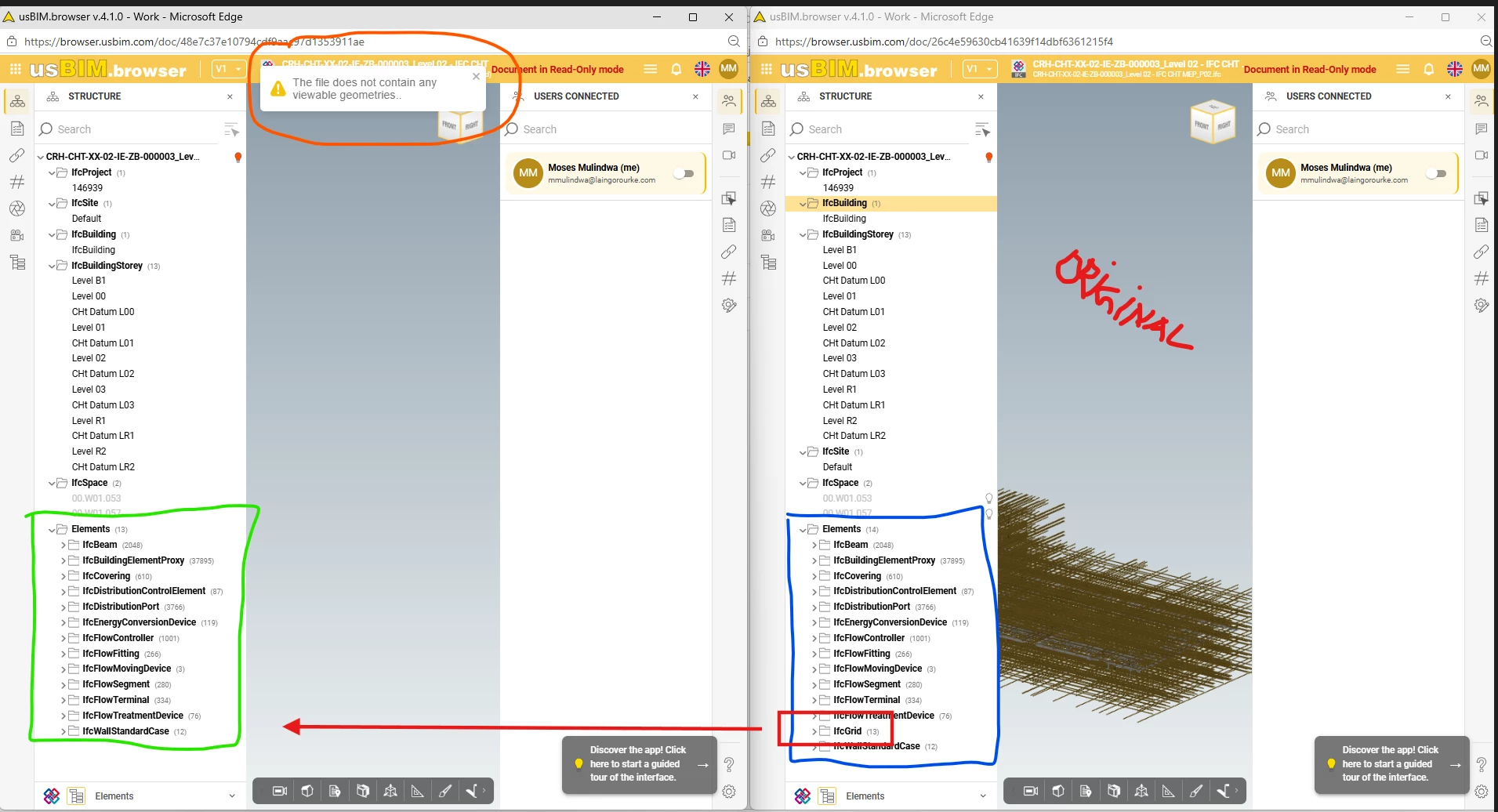

I have managed to remove Geometry and able to extract ONLY attribute, for some reason am missing …….IfcGrid (Element)
I might be missing out some transformer or flow . Its FME 2026.1 , any guess how to get IfcGrid ?

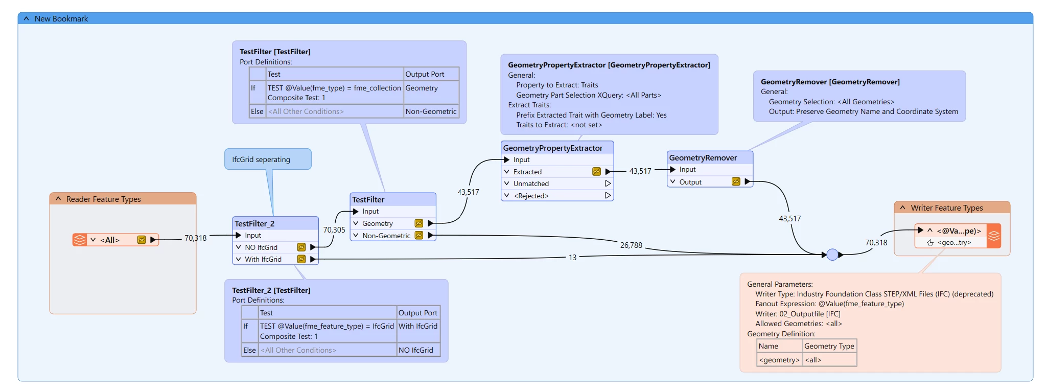

Hi ​@vimva679,
When using the original IFC reader/writer, the Property Sets are stored as part of the geometry, so removing the geometry will remove them as well.
Instead, please use a GeometryPartExtractor to remove the Body and Axis geometry representations from the feature geometries. This will preserve the Property Sets when writing.
Please see the attached updated workspace to illustrate.

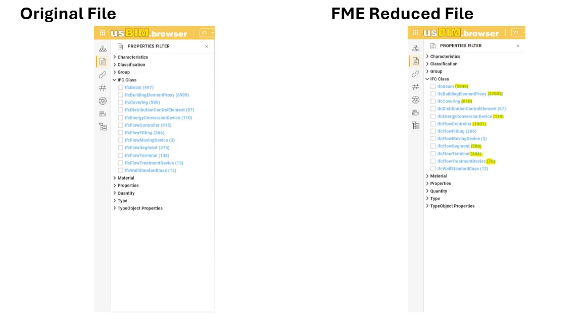

vimva679
Forum|alt.badge.img+11
  • Jul 5, 2026 7:11 AM UTC

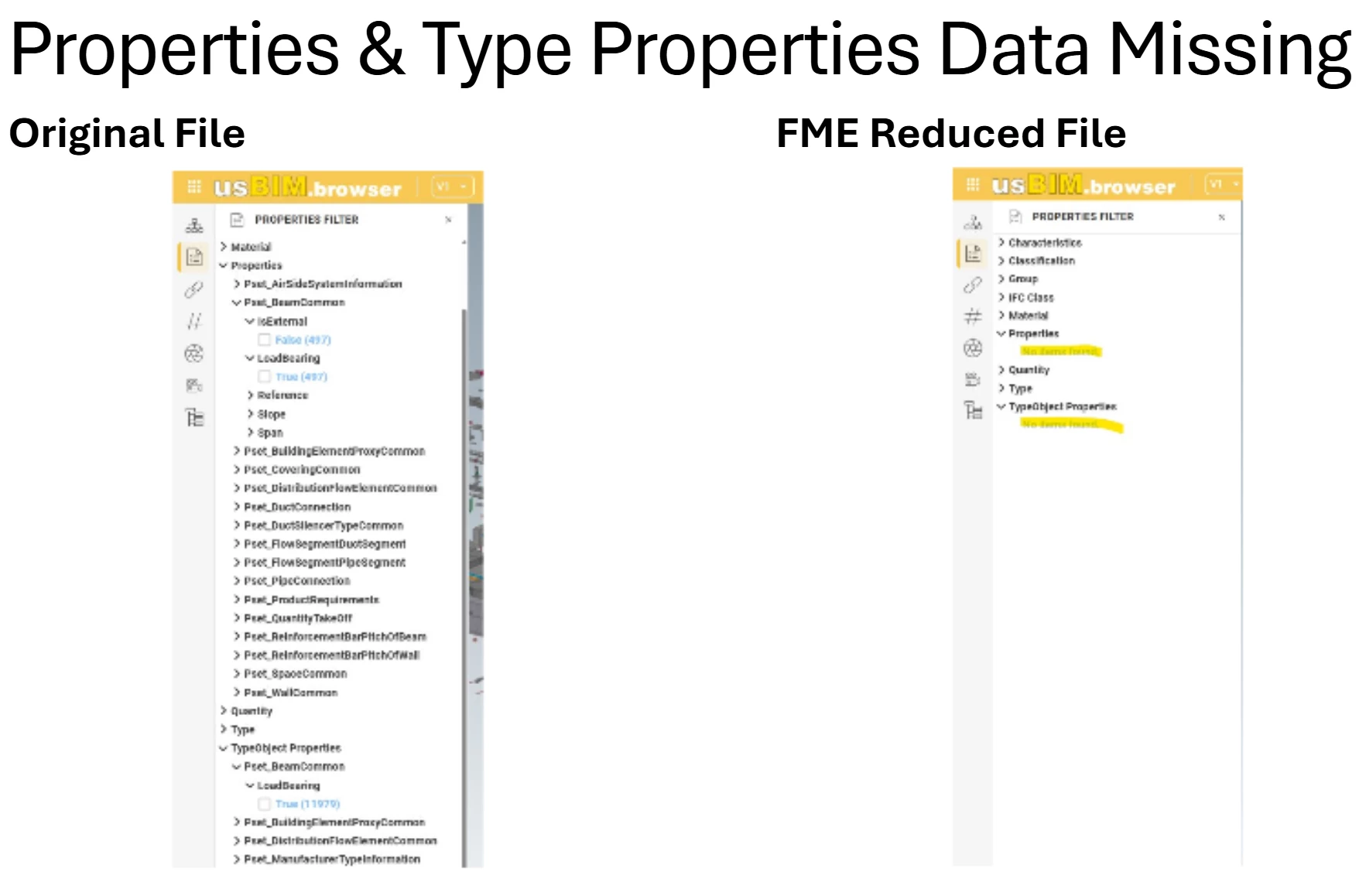

​@daveatsafe
Thank Dave, i have run the Workbench and its still missing IfcGrid properties :( and within the properties its missing sub-properties as below
