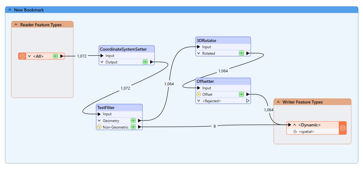

I am not able to understand where and why the Output FILESIZE is NOT the SAME as Input file ? Any idea or suggestion is helpful

With the rotating and offsetting you are changing coordinate values. This may mean that when writing them to a file, they might be rounded differently. With such a small difference I wouldn’t be alarmed right away. A better check is to inspect the output file and see if it matches what you expect.

thank you ​@redgeographics that explains well
