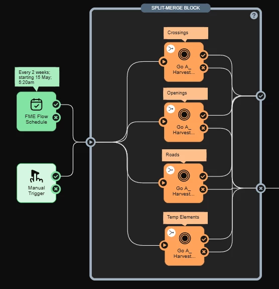

Hi,
I’m using FME Flow 2025.2.4.
I have an FME Flow Automation which runs 4 workspaces. Each workspace takes an email address parameter (which will be the same value for each workspace).
I would like to use the same Automation to run on a bi-weekly schedule but also allow it to be run on demand via an Automation App, so I have 2 triggers: Schedule and Manual
When the Automation is run on Schedule it should pass a pre-defined email address to the workspaces.
When the Automation is run manually via the Automation App the user needs to be able to provide an email address at runtime.
Is this possible? Or do I need to create 2 separate Automations?
I know I can create a manual parameter that gets passed from the manual trigger to the downstream workspaces but if I configure the workspaces to use this value it won’t exist when the Automation is run on schedule.
Similarly, if I use an Automation Parameter for the workspaces when run on a schedule I can’t specify the value at runtime for the manual trigger.
Best answer by matthias_ct
This can be solved using Custom Attributes.
In the Schedule Trigger, define a Custom Attribute email and set it to your default value:
In the Manual Trigger, first define a manual parameter. Then create a Custom Attribute called email and set its value using the manual parameter:
Afterwards, you can pass the custom attribute user.email to the workspaces.

Thanks ​@matthias_ct . Safe Software support helped me out and we arrived at the same solution. I had meant to post it here for reference for other people but got sidetracked with other work, so thanks for sharing this!
