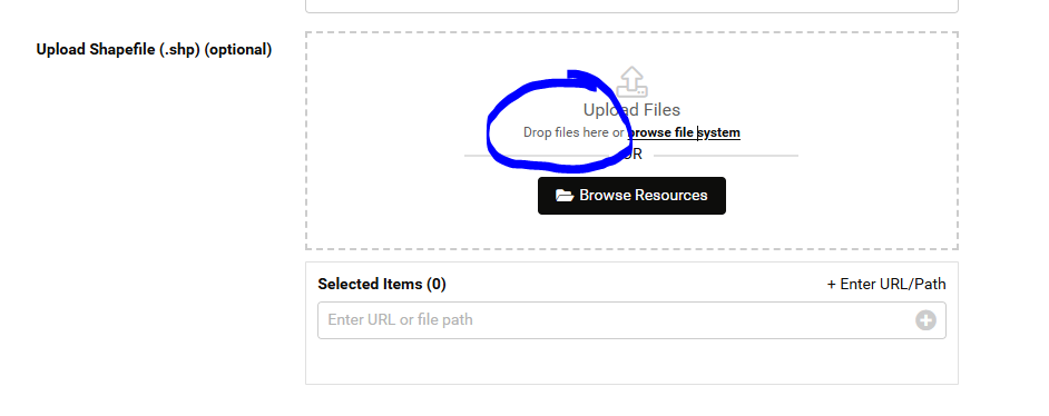

Hi ​@stadimarmiladi Can your users drag and drop the file(s)
