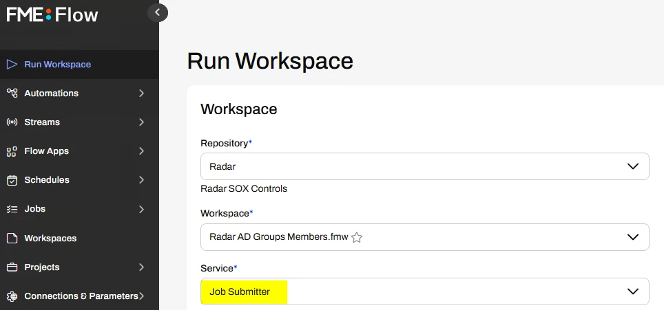

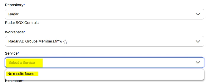

While trying to create a workspace app , I find ‘Service’ dropdown to be empty (pic2). However, I see ‘Job Submitter’ as service in the published workspace (pic1). May be I am missing something as we just started using FME products. Thanks for your review and input.

When the workspace was published from Form to Flow, which services were registered
https://support.safe.com/hc/en-us/articles/25407446827277-Publish-a-Workspace-to-FME-Flow-and-Run-It
Registering web services for your workspace

Working with support team, the issue is resolved with a workaround (using FeatureWriter instead of DocumentPDF writer) and is listed under ‘Known issues’  - see link below. The issue is limited to FME Flow version  ‘2025.0.1’ and is resolved in ‘2025.1.0’.
