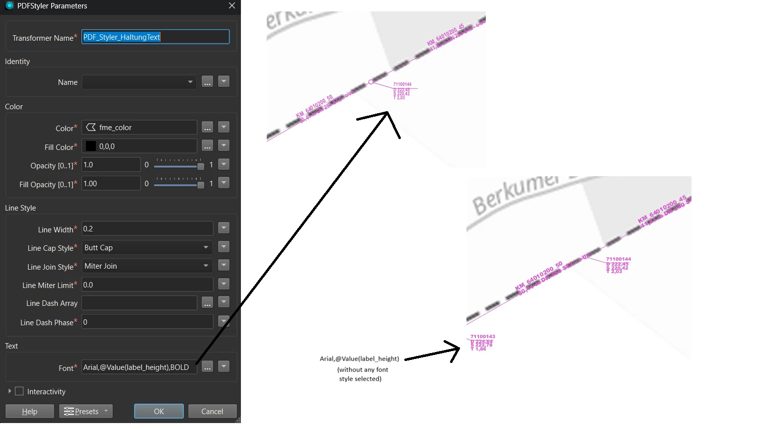

I am using FME 2026.1, trying to create a map using AttributeCreator+ PDFStyler.
However, when I set my label height to for example, Arial,5, my text comes out bold. When I select Arial,5,BOLD, my text comes back looking regular. Is that a bug just for me? I was stuck on it for ages trying to figure it out. Yes, it is also the case when i set a font size like 5 (not from an attribute).

Best answer by hkingsbury
It would be worth submitting this as bug directly to Safe, they’ll be able to confirm if it is or not

Hi ​@fazacasbianca! Looks like you’ve submitted a support case with us!
We’ll dig into your issue there and then update the community once we confirm a solution. Thanks for raising this🙂
