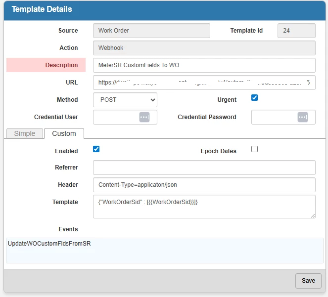

I have a working workbench that accepts a user parameter for a Cityworks WorkOrderSid.  I have a FWM Flow Webhook setup per instructions.  I think my issue is that the work order sid is not getting transfered as expected.  Here is a screenshot of the CW Template Details:

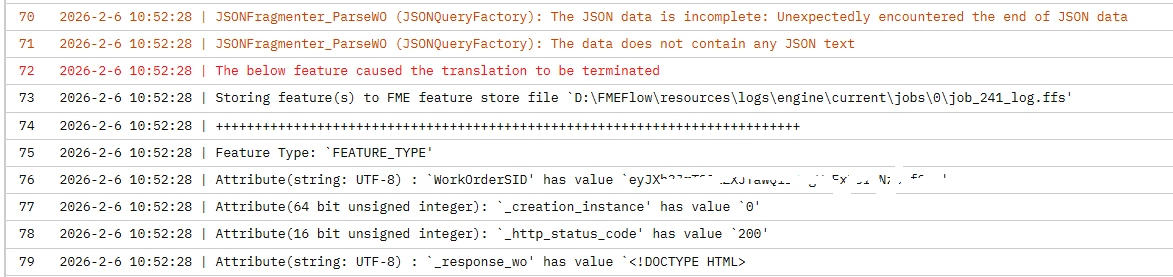

I think the Template text is wrong because im getting an error in FLOW:
it looks like the auth code is getting passed in to the WorkorderSID?

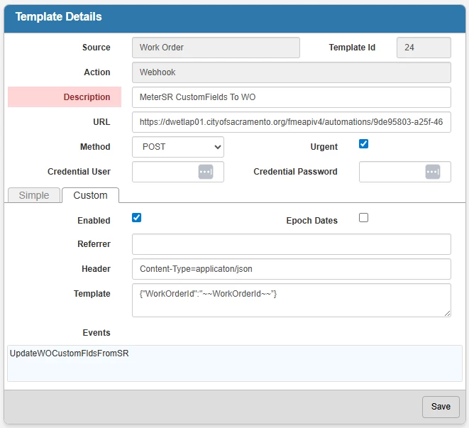

Hi ​@rjohnsoncos,
I’m sorry to hear that you’re running into this issue! Could you please try the following template in CityWorks and see if you get the same error?…
{"WorkOrderId":"~~WorkOrderId~~”}

rjohnsoncos
Forum|alt.badge.img+2

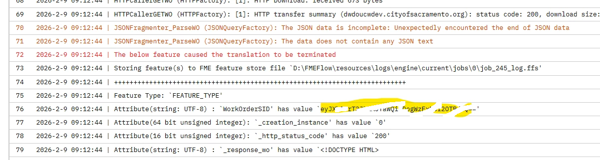

  • Feb 9, 2026 5:41 PM UTC
tried but still getting an error of some sort.  I really looks as though the auth token is getting passed to the workofersid value?
