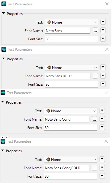

Hello everyone — I’m struggling with the Mapnick rasterizer and would really appreciate some help. I’m using the Mapnick Rasterizer and need to render labels with the Noto Sans Condensed font;
I’m attaching screenshots that illustrate the problem:
Mapnick outputs configured to use: Noto Sans, Noto Sans Bold, Noto Sans Condensed, Noto Sans Condensed Bold.

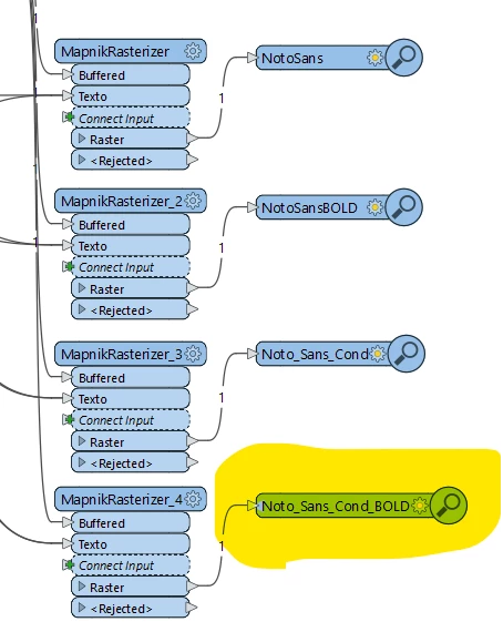

Mapnick open showing the four font settings for each situation.

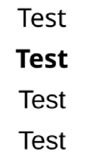

The result, showing that Noto Sans applies Bold, but Noto Sans Cond does not apply Bold.

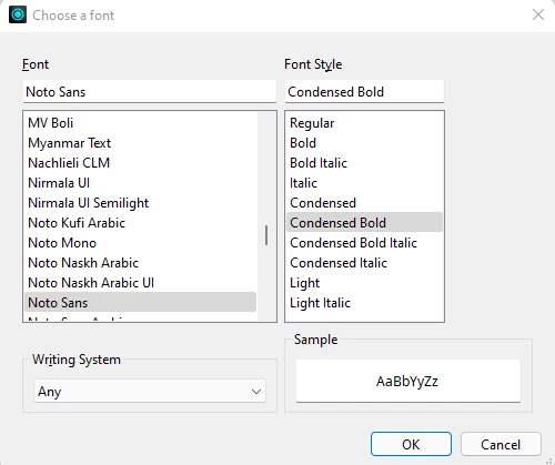

Noto Sans font configuration — but the Mapnick Rasterizer, although it shows Condensed + Bold in the font styles, does not accept selecting it and always reverts to only Bold.
