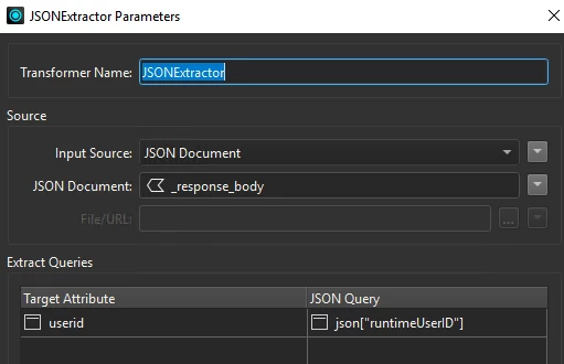

You don’t mention what transformer you are using to try and extract this but a JSONExtractor should be very straightforward

Hi Arthur, it’s not currently possible to parse JSON within the text editor for Automation parameters. This must be done in a workspace as ebygomm suggested. You could use a Run Workspace action in the automation, send the HTTP requests from inside that workspace using HTTPCallers, and parse their response bodies using JSON transformers like the JSONExtractor to keep things simple.
