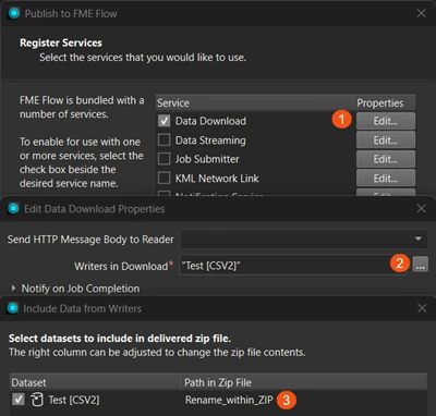

You can control the folder/file paths inside the zip file by setting it in the Data Download service settings. When you publish to FME Flow, navigate to Include Data from Writers and then rename the file under Path to Zip File.
Unfortunately at this time, the zip file name itself cannot be customized. I encourage you to upvote the Idea in the FME Community. Our product team reviews the Ideas list and will consider them for future inclusion in FME.
