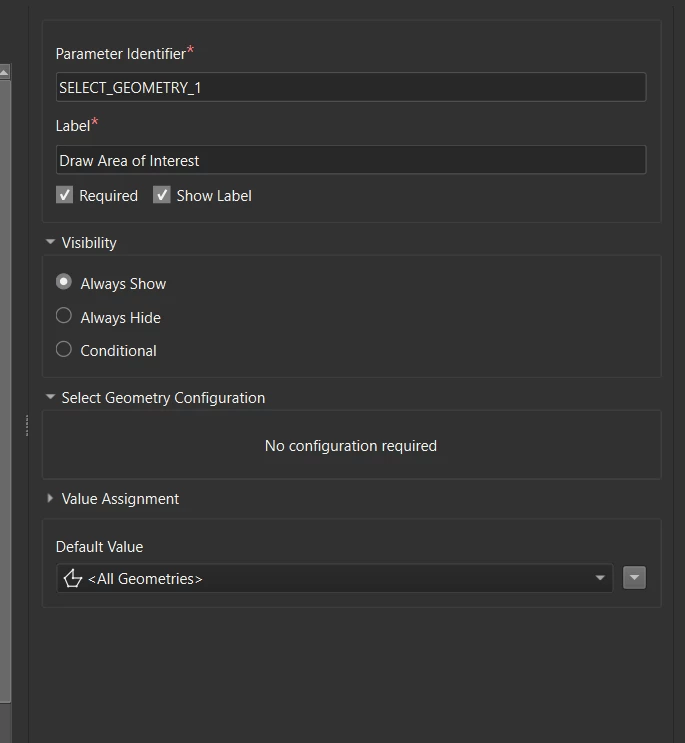

I am using the Geometry Parameter to let the users draw their area of interest on FME Flow and then download the respective map. However, after publishing to FME Flow, I don’t see the map for the selection, nor am I able to turn it on in any way.
I saw that usually there should be a map icon to the left of the text, which would open a map and let me draw a polygon of my AOI.
What is the problem? I am using FME 2026.2.0.0 20260401 - Build 26291 and FME Flow 2026.1.1 Build 26121 (which should be compatible).

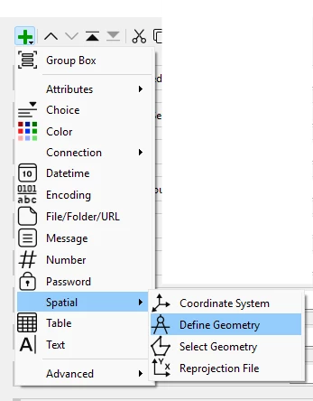

Best answer by max_h
It looks like your user parameter is “select geometry” instead of “define geometry”

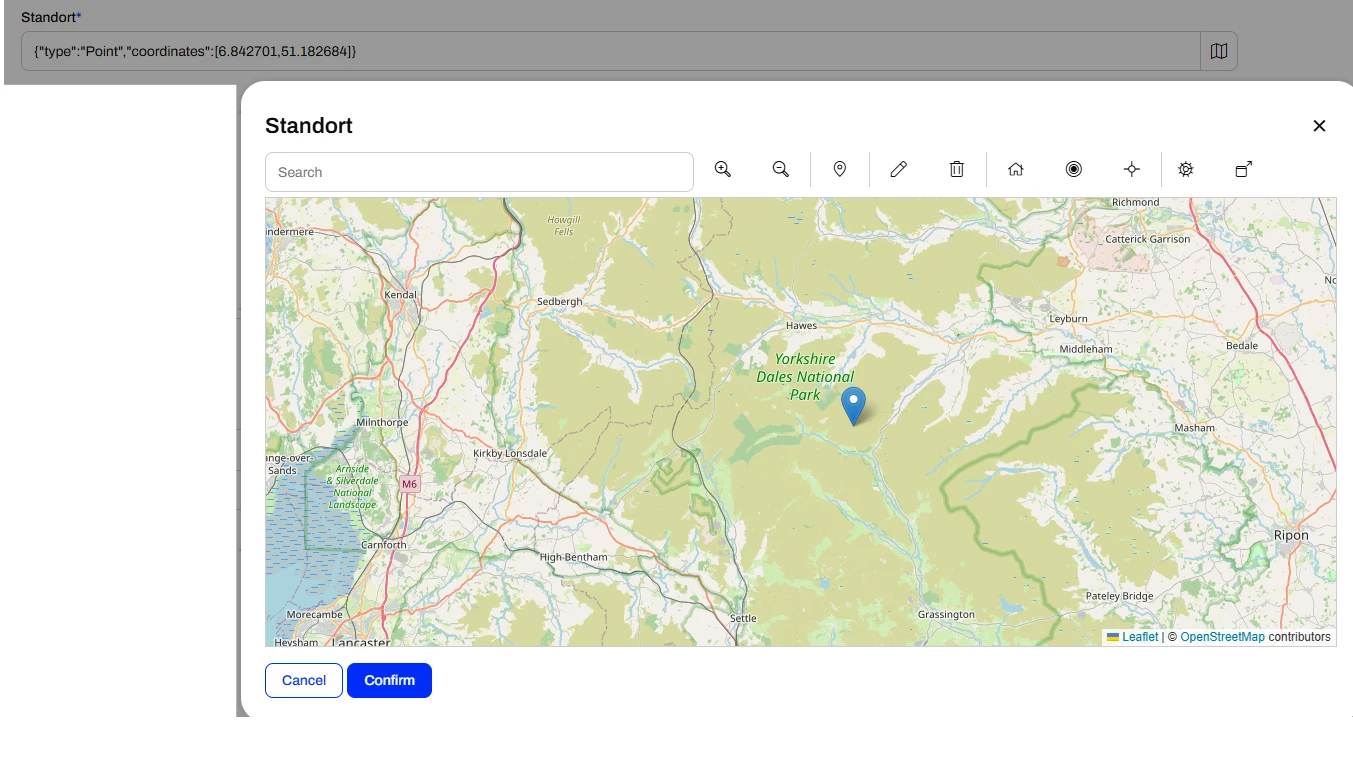

With “define” it should look like this:
