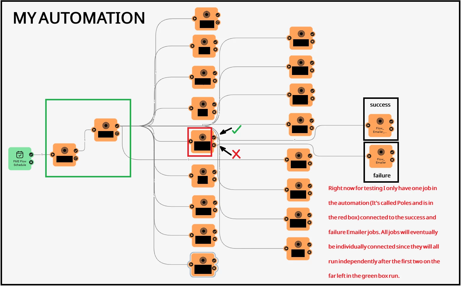

Hello Everyone,
I have an FME Flow 2025.2.4 automation that contains nineteen individual FME Form 2025.2.4  jobs. In addition to those nineteen jobs, I have two separate FME Form jobs that are used only for email notifications. One notification job is intended to run when jobs succeed, and the other is intended to run when jobs fail. Both of these notification jobs contain an FME Form 2025.2.4 Emailer transformer in their build.
All nineteen FME jobs in my automation are connected to the Success notification job through their success ports, and those same nineteen FME jobs are connected to the Failure notification job through their failure ports. This wiring ensures that the appropriate notification workflow is triggered depending on the outcome of each job.
The goal is not to send an email for every individual job result. Instead, the goal is to send a single consolidated email per outcome type of Succeed and/or Failure. For example, if nine jobs succeed and ten jobs fail during an automation run, the desired result is two emails total:
  • One email listing the names of the nine successful jobs
  • One email listing the names of the ten failed jobs
If all nineteen jobs succeed, only one success email should be sent containing all nineteen job names. Similarly, if all nineteen jobs fail, only one failure email should be sent containing all nineteen job names.
  • One email listing the names of the nineteen successful jobs
Or
  • One email listing the names of the nineteen failed jobs
To achieve this, each of the nineteen jobs needs to pass its own job name to the notification jobs at runtime using automation output attributes. The success and failure notification jobs then collect all incoming job names, aggregate them within the workspace, and generate a single email per outcome with a complete list of job names.
I am trying my hardest to avoid excessive daily email notifications while still providing clear visibility into which jobs succeeded or failed during each daily automation run.

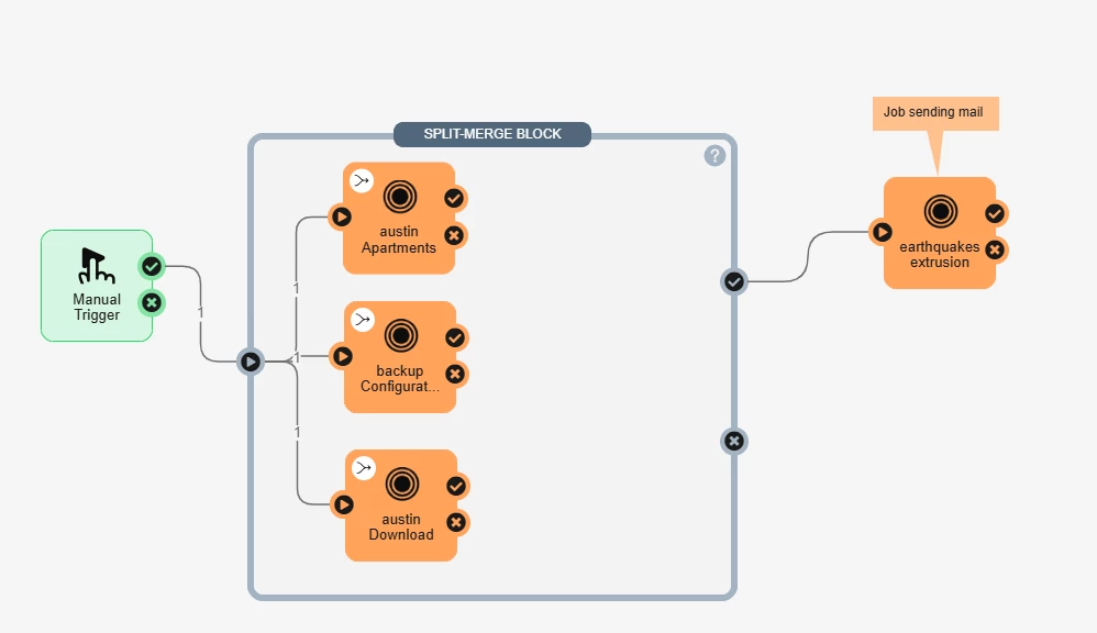

One possible approach is to use a Split-Merge Block in combination with the FME Flow REST API:
  • Configure the Split-Merge Block as shown in the screenshot.
    Do not connect any output port to the Split-Merge Block’s output port. This ensures that exactly one feature is emitted once all jobs within the block have completed, see https://support.safe.com/hc/en-us/articles/25407747491597-Understanding-the-Split-Merge-Block-Troubleshooting-FAQs
  • As a result, the downstream workspace (which is responsible for sending one or two emails) is executed only once.
  • This workspace should include a parameter that contains the event_id, which is passed from the trigger.
  • Within the workspace, use the REST API to retrieve all relevant jobs:
    • First, call:
      fmeapiv4/jobs?status=success&status=failure&sourceType=automations&sourceID=<automation_id>
    • Then, you get an array. Each element of this array contains the job_id. For each job_id call:
      fmeapiv4/jobs/id
  • Each job payload includes an event_id. By comparing this value with the event_id provided via the workspace parameter, you can identify which jobs belong to the triggered automation.
  • Once the relevant jobs are identified, use their job status to control the logic. Based on this, create one or two features and pass them to the Emailer transformer.
    • First, call:
      fmeapiv4/jobs/id

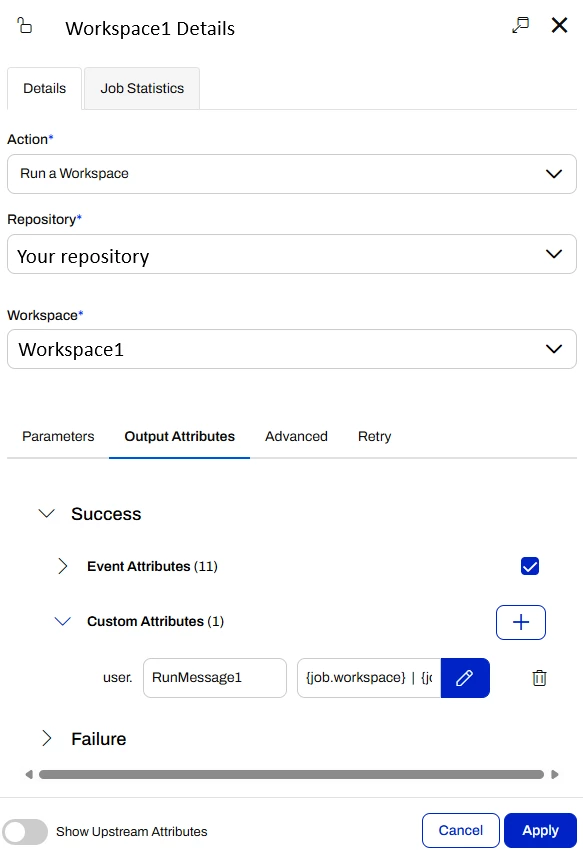

I am working through a similar process (wanting a summary email of success/failure of the workbenches in an automation) and ​Zoe with Safe Support suggested using custom attributes as an alternate solution.
This is a simpler solution for what I am needing so I am passing the info along.

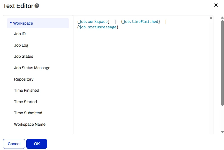

For each of your workbenches you would create a custom attribute under output attributes:
For the value, you select the workspace attributes (or other information) you are wanting to be emailed to you e.g.

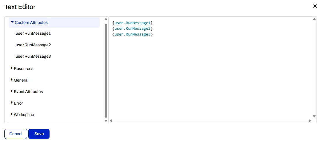

Repeat this for each of the workspaces and then set the email body to be your custom attributes e.g.
The email should look like this:
Workspace1Name.fmw  |  Tue-16-Jun-2026 09:10:00 AM  | Translation Successful
Workspace2Name.fmw  |  Tue-16-Jun-2026 09:15:00 AM  | Translation Successful
Workspace3Name.fmw  |  Tue-16-Jun-2026 09:20:00 AM  | Translation Successful
