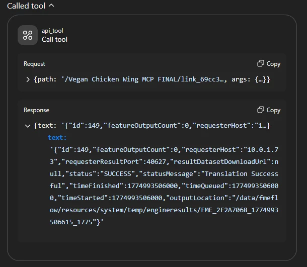

Hey ​@rsun I just tested with ChatGPT and was able to recreate this issue using a FeatureWriter.
From what I can see, if you use a FeatureWriter instead of a “traditional” writer to stream your JSON, your AI tool (claude or in this case ChatGPT), only receives part of your translation log as a response. But if you switch to a JSON writer for instance, it works.
Here is a screenshot of what ChatGPT returns after calling my MCP tool that uses a FeatureWriter to stream the JSON :
But same request with a JSON Writer streams the JSON as expected to ChatGPT!
