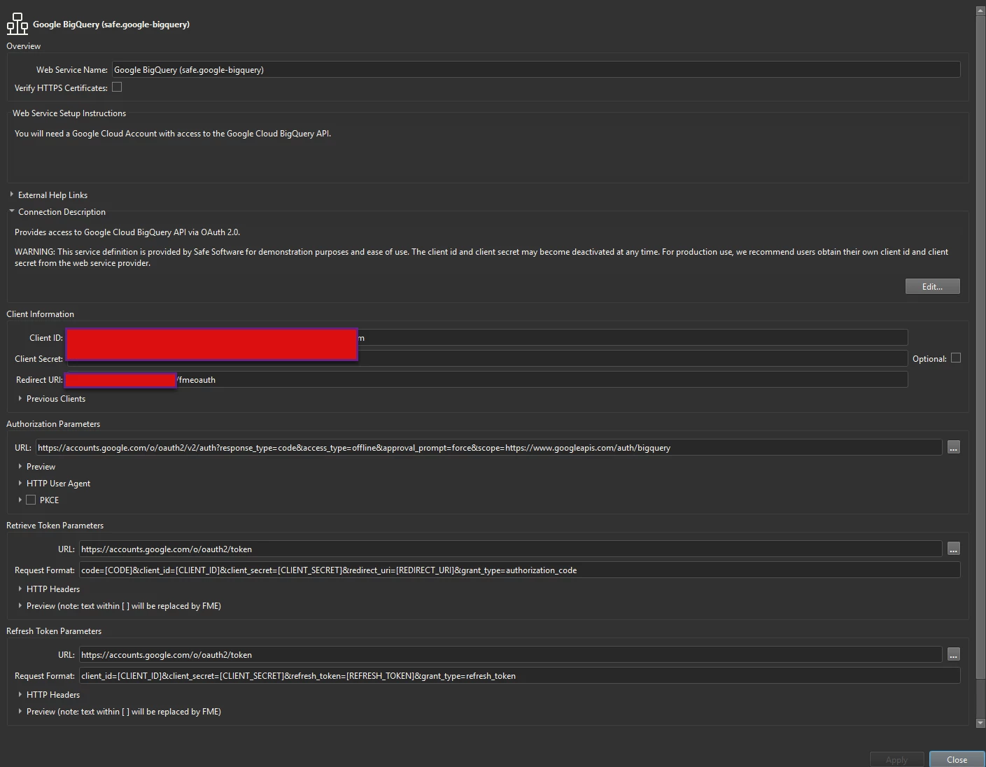

We setup an OAuth client in GCP that we’re trying to get working with FME Flow. I have installed the safe.google-bigquery package on FME Form and configured the web service with our unique client information from GCP. See below

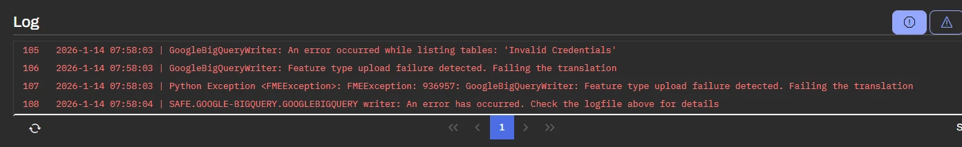

I then created a web connection based on this web service and uploaded this and a workspace utilizing this connection to our FME Flow instance. The workspace succeeds initially, presumably until the access token expires, but is failing with the following error after an hour or so:
It works again if I manually re-authorize the connection so I believe Flow is failing to retrieve a refresh token from GCP:

Often times when web connections work temporarily on FME Flow the issue is the web service from Form. I haven’t personally used BigQuery, but this issue arises for other OAuth 2.0 web connections.
Did you create a copy of the Google BigQuery template before adding your credentials and uploading that to FME Flow? Part 2 in the article Creating an OAuth 2.0 Web Service and Connection in FME explains how to do this.

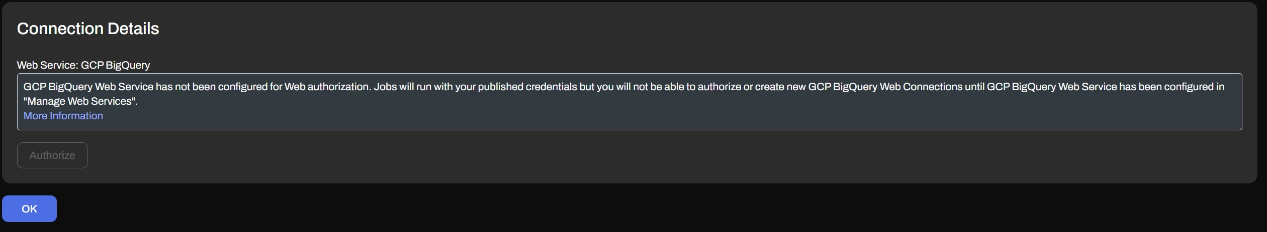

Thanks for your response. I did try creating a new web service and connection based on the Google BigQuery (safe.google-bigquery) template and performed the initial authorization on FME Form. Once I published that connection, service and workspace to Flow, the job succeeded even though it says this new web service has not been configured for Web authorization.

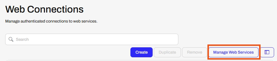

There are two parts to authenticating web services on FME Flow. First you need to add the details (client secret and redirect URI) under “Manage Web Services”, then you can authenticate the connection in Web Connections.
If the steps in Manage Web Services aren’t completed, the Authorize button will be greyed out.
Were both steps completed?
