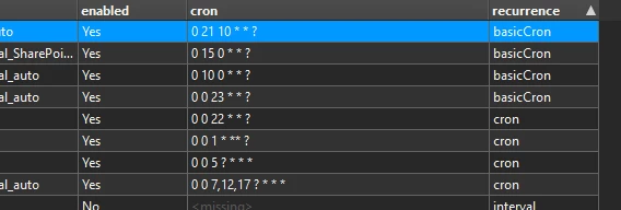

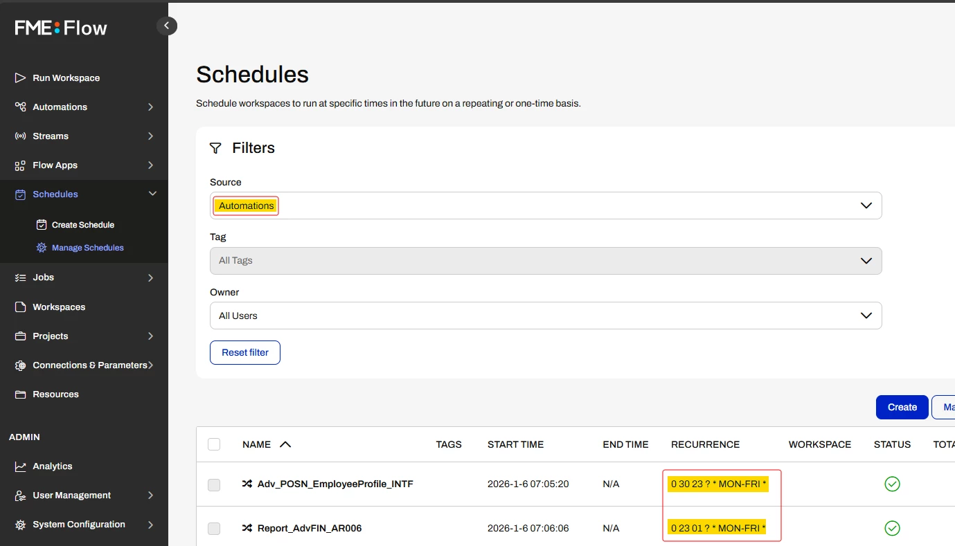

​@ebygomm The API call is exactly what I was looking for.  Thank you.  The API call also led me to look at the filters on the Schedules.  In the Filters Source drop down I can select Automation and it shows the CRON setting in the RECURRENCE column.
I’ll be using the API call as it gives me additional information that the web page doesn’t.

For anyone who comes across this in future, it doesn’t appear to be documented but
FMEURL/fmeapiv4/schedules?limit=100&offset=0&sourceType=automation
will return details of automations triggered with a schedule using the last version of the rest api
