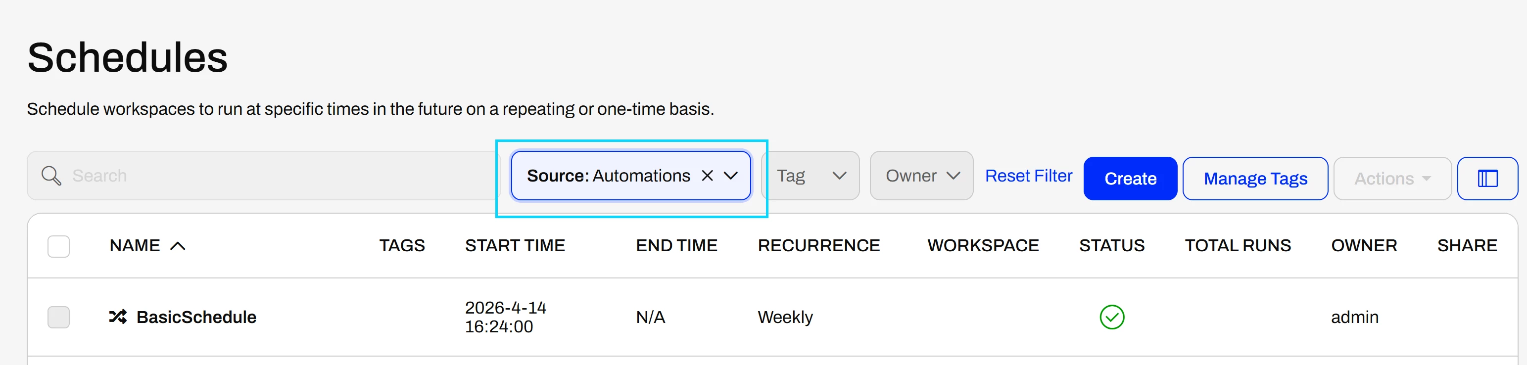

Hi ​@maschinensturm, I looked into this and see that the fmesuperuser role is required to use this query parameter, or to filter from the UI:
Use of the /schedules endpoint in this way is unsupported, as the sourceType parameter doesn’t appear in the docs. This means it’s subject to change without notice between versions, and may not conform to our usual API standards.
I submitted IDEA-3309 internally to track this, requesting that:
  • This query parameter be supported.
  • Fewer, more granular permissions be required to use this.
