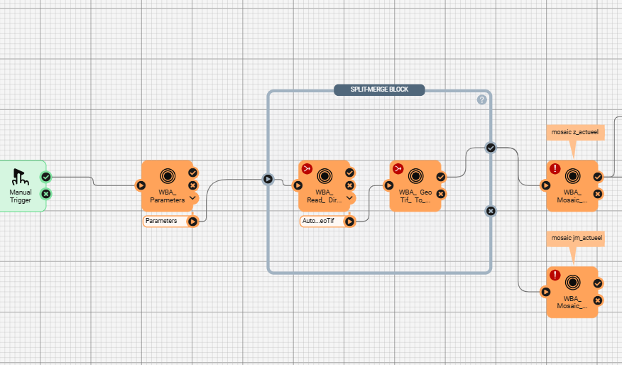

I am creating an Automations proces and when assigning the parameters to an integer field  get the following message: Must be a whole number. Decimals are not supported.
In the Automations first a csv is read for creating all sorts of parameters
In here there are no decimals.
In the workspace tm_data has the Type int16
In the Automations writer it is also defined as integer.
But when assigning the parameters, I receive the error. This applies for all integers I use in this.
This is a automations proces that I also build in Server 2021 and I didn't have this issue but in Flow 2024 I can't get any further because of this error.
Is there something I do wrong or is this a bug?

I forgot to mention, in the picture tm_datum is set as Type int16, but I changed is to int32 because the number is too big for a int16. But that did not change the problem.

Kgnadt,
I don't have a solution but I found out that if I just assign the correct fields to the parameters, click Apply and close the configuration, even though in the Automations you will get a lot of red exclamation marks or red connections, like you see in the picture below, it won't give a problem while running the automations. If you open the configuration of the workspace, you will notice that the message in red has disappeared. The red exclamation marks or connections will stay.
