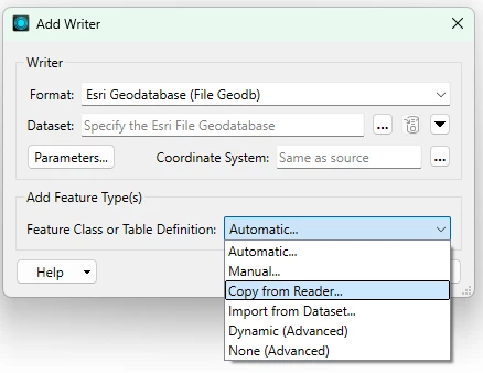

Forum|alt.badge.img+2
To follow up on this, the solution is when the Esri Geodatabase Writer is added the Feature Type Definition has to be set to Copy from Reader.
