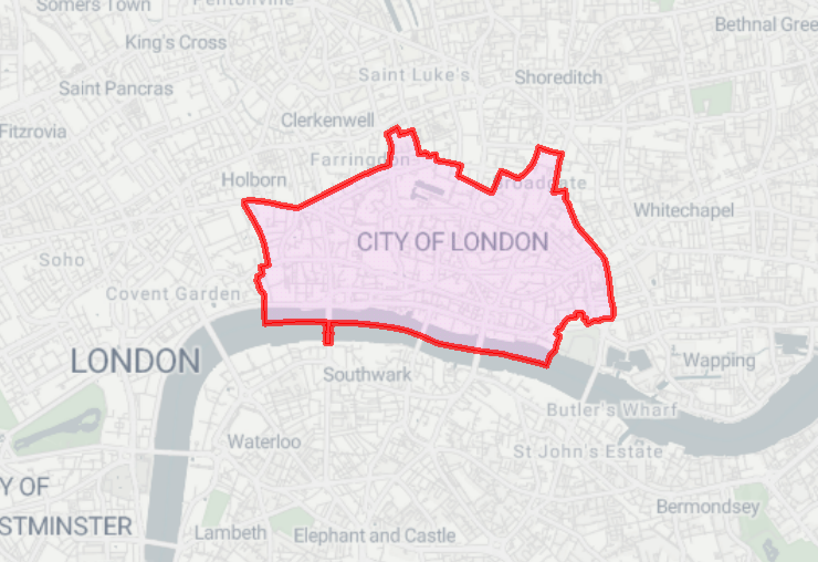

I need to display an outline of GIS data on a basemap that runs in a Flow app. For example, an area shapefile. This is to display the area of operations, as a starting point when using the app, and the users will then select areas within that area to grab other data (addresses and statistics etc).
I’ve been working through this: Using the Geometry Parameter – FME Support Center to get a workspace built and published to Flow. But how do I ensure the outline of the area of operations is displayed from the very start?

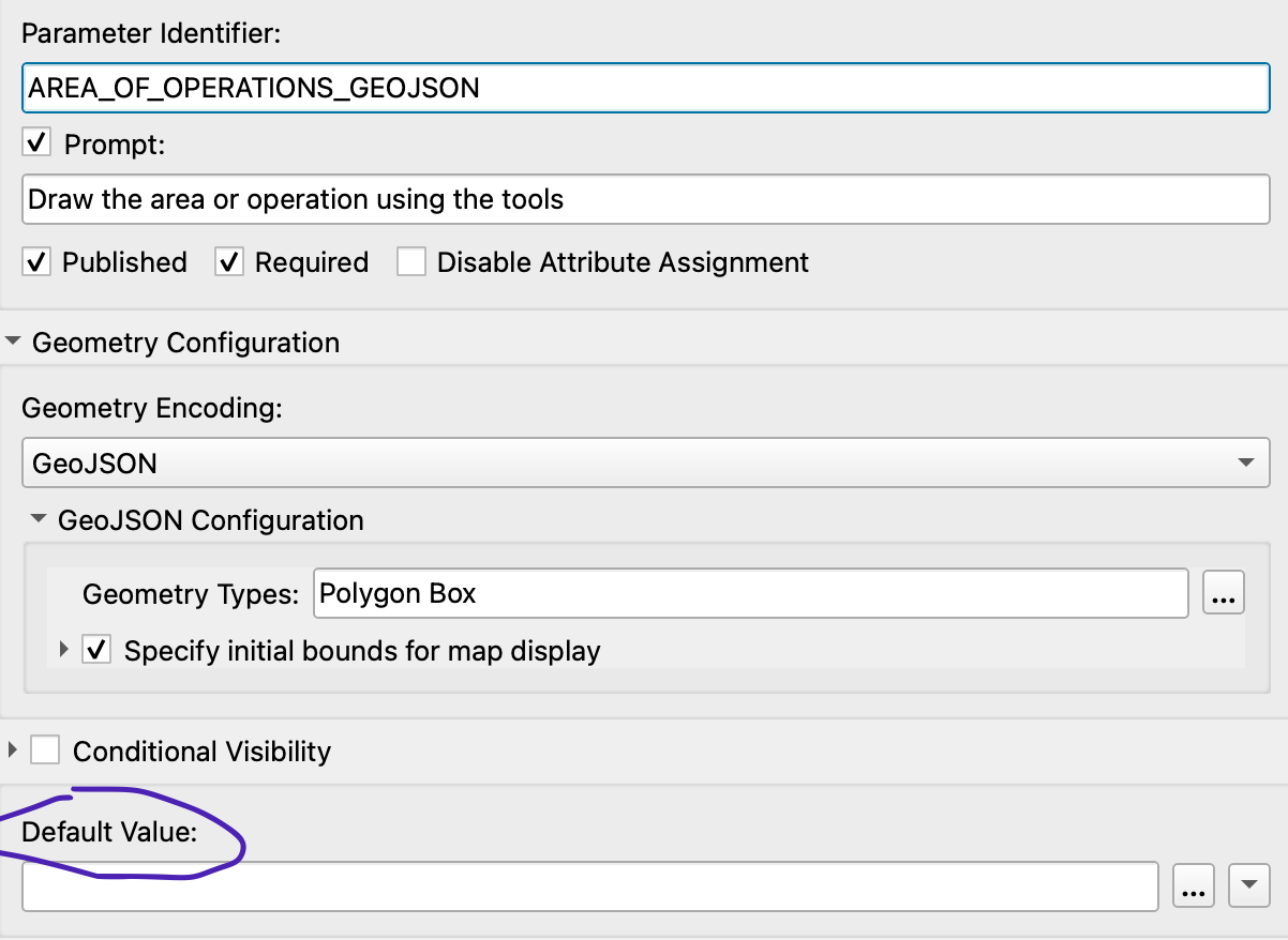

Unsure if this would work, but you could try setting the default for the Geometry user parameter, making it the GeoJSON of the area of operations.
You'll need to convert and capture the geojson perhaps using GeometryExtractor to the output _geometry attribute

THANK YOU!!!! You are absolutely correct, and this hit the nail on the head.
I created a GeoJSON file of the area, opened that with Notepad++, copied the contents and pasted it into the Default Value as suggested. Opened the app and there it is.
