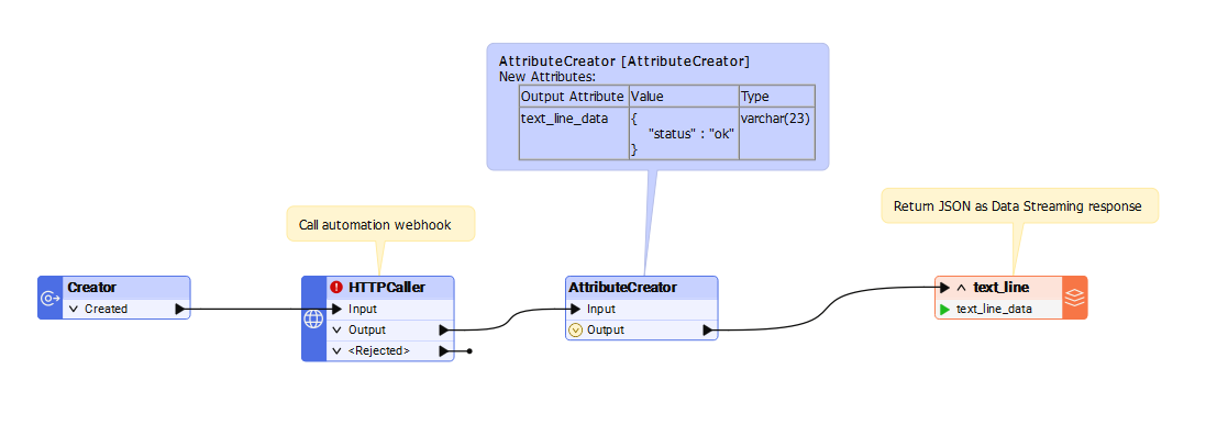

An easier way to implement that without topic notification system :
You can use this workspace as a “proxy” that will trigger your automation and return custom JSON data to your client application.
