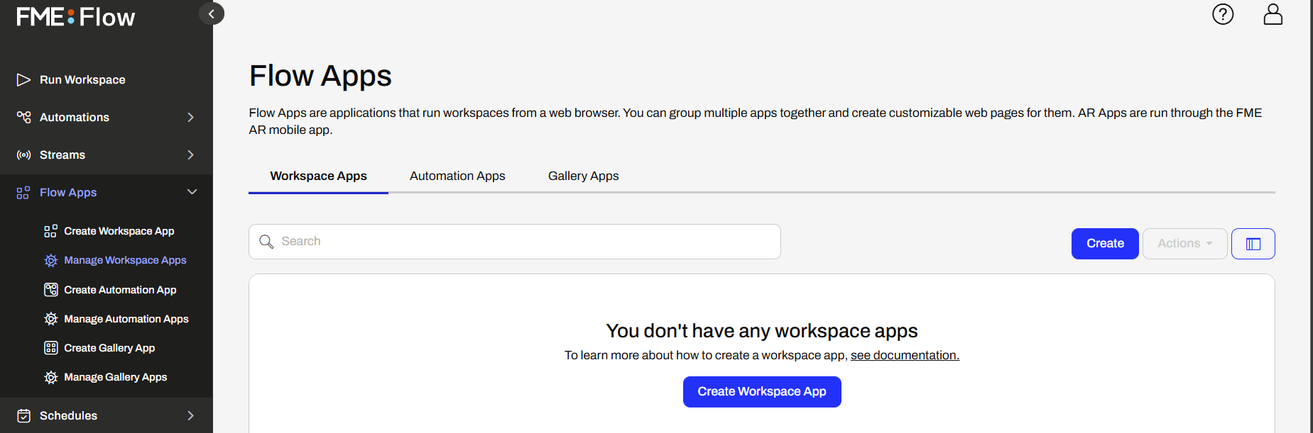

So in one of the tutorial for creating AR, the screenshot of FME Flow has the Create AR App option in Flow Apps. But I opened my FME Flow 2025.02 version, it only appears these options without Create AR App:
Is anyone having the same issue? Is there anything I did wrong?
Thank you so much for the help.

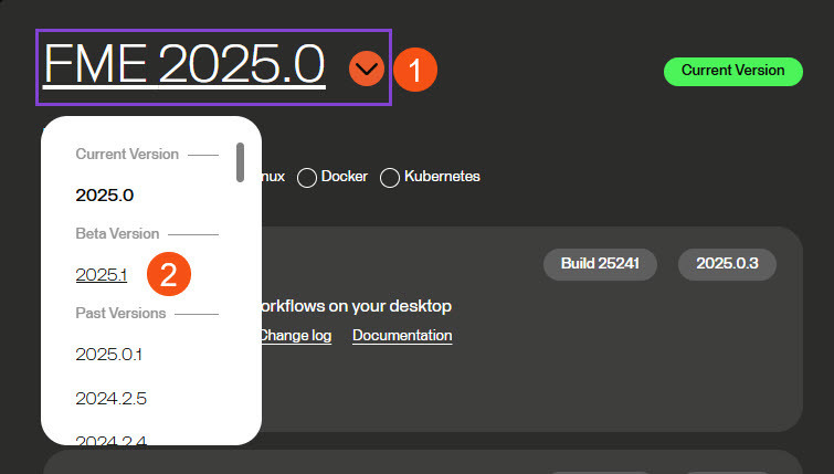

Hi ​@smjie,
You can download the beta release of FME Flow and FME Form (2025.1) from our downloads page to test AR applications. This version is available now and is currently the only way to use AR Apps. To access it, click the dropdown next to the current version and select 2025.1. Please note that this is a beta version and should not be used in production environments.
