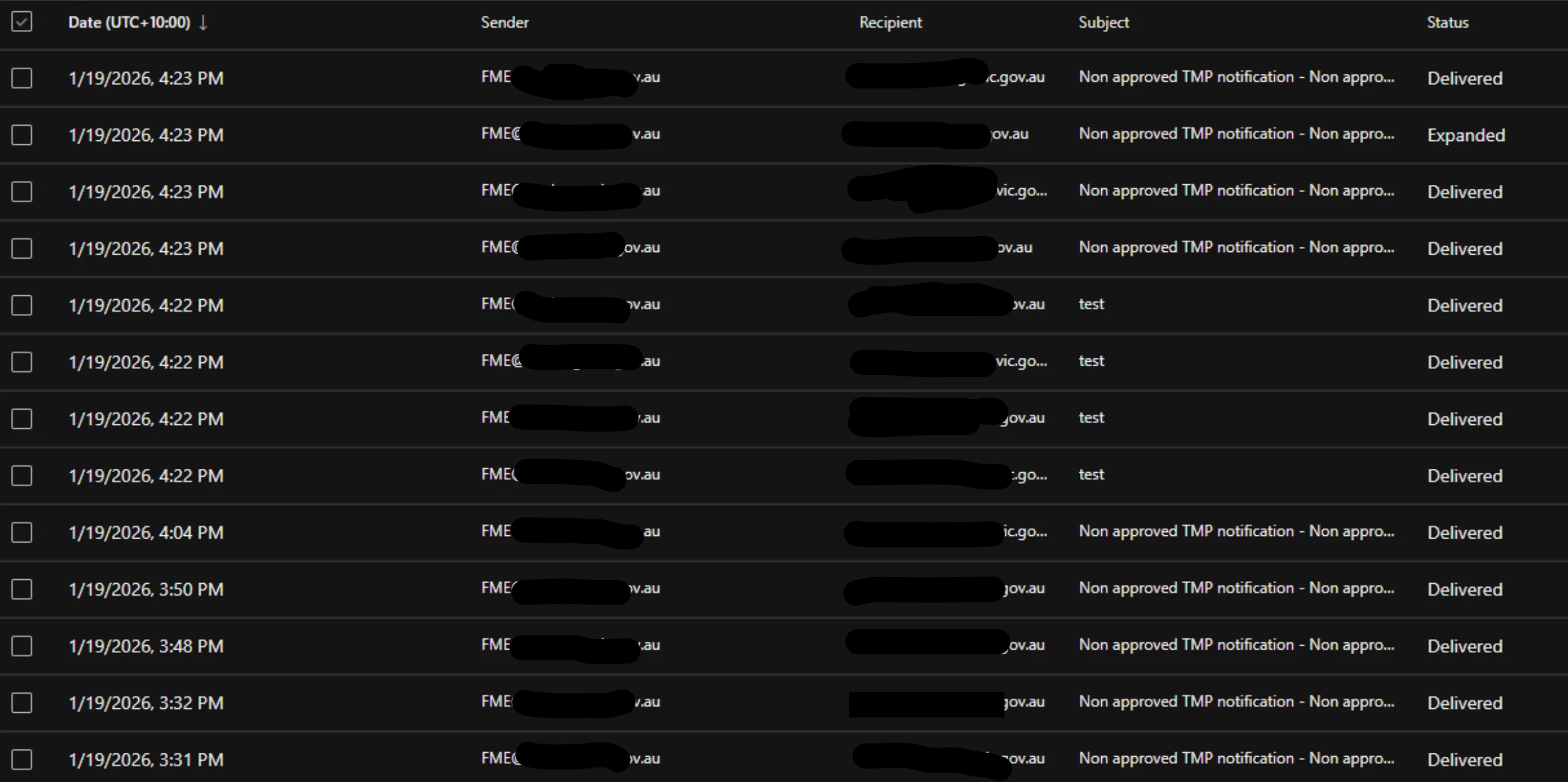

In Automation, I can successfully send out emails when there’s only one receiver, but when I try multiple receivers or use CC, it will fail with error:
Mon-19-Jan-2026 04:50:36.849 pm | INFORM | pool-2-thread-74 | Email testing (9e665a4d-a425-4960-b8e6-9395ec70a77d) | event (fd5e556f-ed1a-4fca-ad50-df7d5ffc22e3) | 801007 : Sending email with subject "Email testing - Non approved TMP notification" to recipient(s) "xx@xxx.gov.au, xx@xxx.gov.au" ...
 | ERROR  | pool-2-thread-74 | Email testing (9e665a4d-a425-4960-b8e6-9395ec70a77d) | event (fd5e556f-ed1a-4fca-ad50-df7d5ffc22e3) | 801027 : An exception occurred. Invalid Addresses
Success log:
Mon-19-Jan-2026 03:35:56.273 pm | INFORM | pool-2-thread-61 | Non approved TMP notification (e97e7a37-d7f6-4452-86b6-0c71e2a1decc) | event (640991ed-84e5-46b3-939f-cac134976325) | 801007 : Sending email with subject "Non approved TMP notification - Non approved TMP notification" to recipient(s) "xx@xxx.gov.au" ...
Mon-19-Jan-2026 03:35:57.116 pm | INFORM | pool-2-thread-61 | Non approved TMP notification (e97e7a37-d7f6-4452-86b6-0c71e2a1decc) | event (640991ed-84e5-46b3-939f-cac134976325) | 801019 : Successfully sent email.

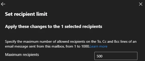

In outlook, the recipient limit been set to 500. Any other place I should look at?

​@hkingsbury I checked with our IT, there’s no failed log on their side, feels like Flow is not sending those out before it even reaches email server.
