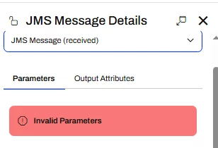

Currently doing some testing after upgrading FMEFlow to 2025.2.1
It appears that the validate button on the JMS trigger now just returns an ‘Invalid Parameter’ message
Previously it produced something slightly more descriptive.
i.e. Failed to find JMS object / Realm is currently not reachable
Is a more detailed message available in a log somewhere, if so where should i look?
I have it all set up and working correctly in 2025.2.1, this is just for future reference.

When the automation is turned on these errors end up in \logs\core\current\publishers\*_jms.log
I’m specifically interested if anything ends up logged when you press the validate button when the automation is switched off.

Hello,
I checked with the dev team and can confirm this is a bug . I have filled a ticket for validation check to continue to return a more descriptive status message [FMEFLOW-27537].
