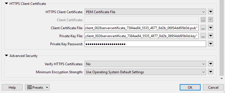

The HTTPcaller works when we put in the HTTPCaller the option 'Verify HTTPS Certificates' to 'No’, see printscreen below.

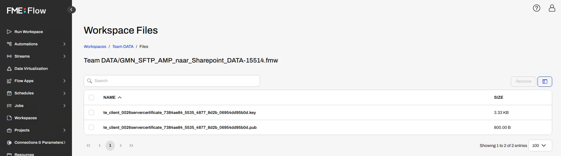

When we look in FME Flow by Workspaces we see by this particular workspace under 'files’ the two certificate files we used in the HTTPCaller, see printscreen below. This gave us confidence that the files are available. However, when it didn't work we also made this files avaible under 'Resources’ in FME Flow.
