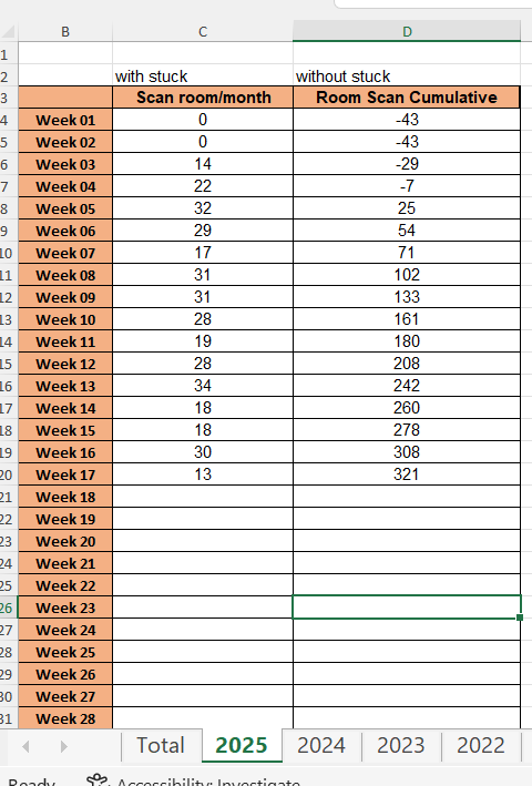

Excel tracker on TEAMS
  1. ON TEAMS : I have day-to-day job task tracker in Excel format.

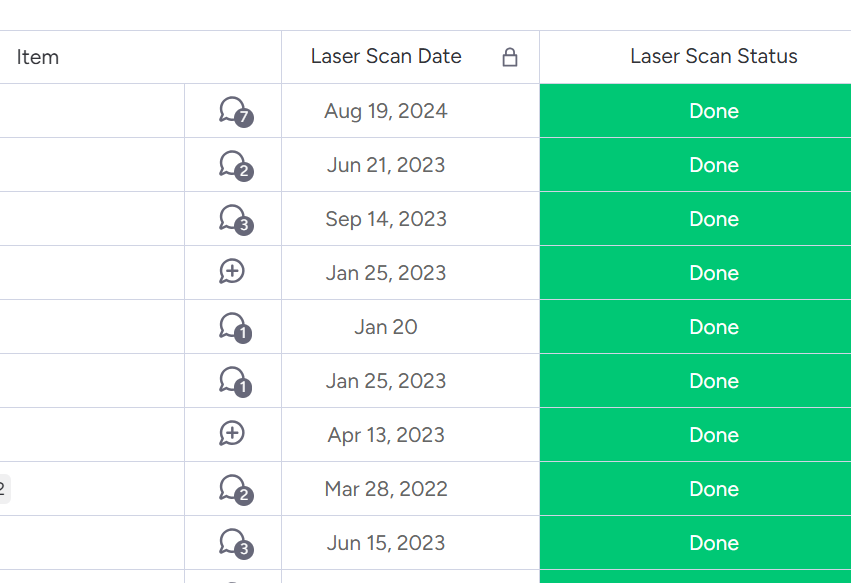

  1. ON MONDAY.COM: The team members go and update data (dates, complete / in progress status, this Monday.com data could be manually downloaded in excel file
ACTION / INPUT required : I would like to do fully automate process meaning:
  1. FME connect and pick /extract data from MONDAY.com

  3. FME goes back and APPEND the new statistics in Excel file stored on TEAMS.
