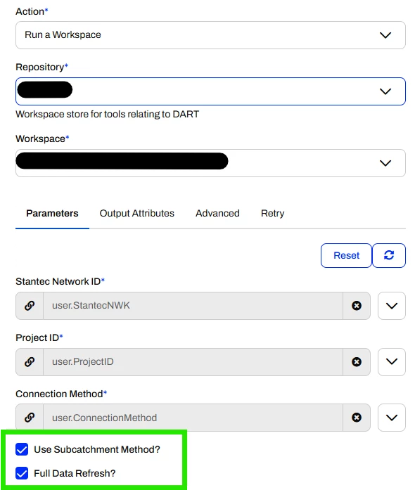

I have a Flow Automation that is triggered by webhook with various parameters within the URL. I can assign those user parameters from my webhook to my workspace parameters, unless they are Boolean parameters. Those are just shown as tickboxes without being able to getting assigned a user value. Am I missing something?
The two Boolean parameters in the green box cannot be assigned a user key value.
We’re on FME Flow 2025.1
The current workaround seems to be to change the User Parameter type in FME Form(!) from Boolean to Choice

Hi ​@arnold_bijlsma,
Unfortunately, booleans being shown as a checkbox is a type system constraint.  Boolean parameters do not support dynamic assignments from automation attributes. The Choice parameter or a Text parameter would be your go-to option in these scenarios.
​​​ ​​​ ​​​​​-  Luke H
