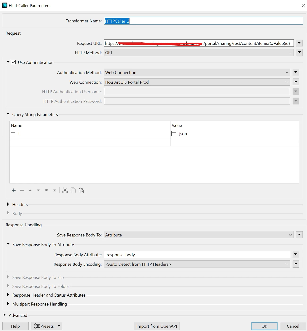

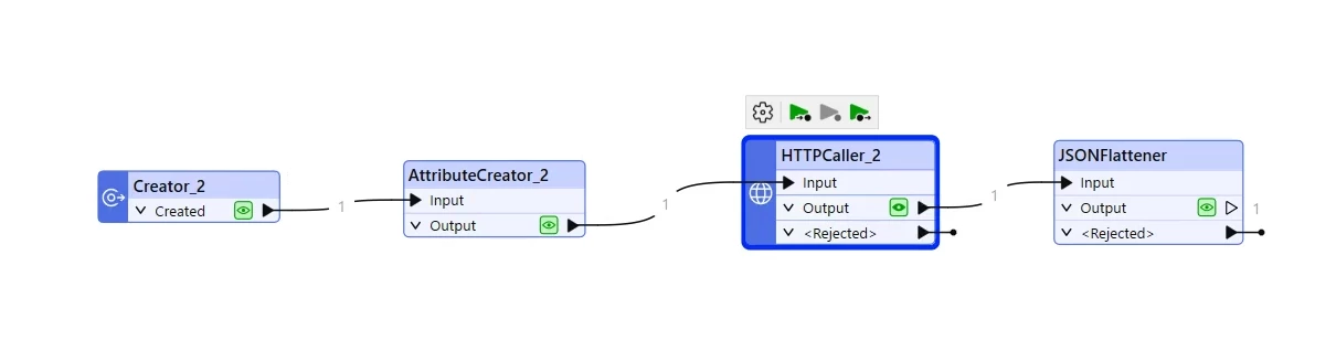

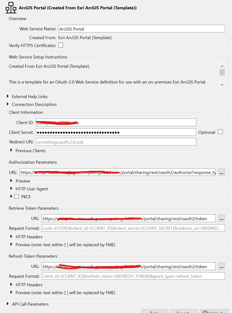

​@macatsafe. There are no HTTP status code/response body from the HTTPCaller in the FME Flow log. The HTTPCaller uses a web connection based on the Esri ArcGIS Portal (template), see attached. I am also attaching the HttpCaller detail. To simplify, I just test the hard coded URL in the workbench, also see attached. The workspace runs ok in FME Form, but fails on the Flow with this error:
HTTPCaller_2 (HTTPFactory): An error occurred while accessing the URL 'https://myArcGISlURL/portal/sharing/rest/content/items/a74b63b48a5d4ba2b9c155bfa54d14fd?f=json&token=fO9NXeSB_AtY4_5QTw6DbFbf0kgkuZIQ1gB8HEfW5V5X7hlWug1er6YSGF9X_ANbEAURAEWY_XXed6g6Qq6tO9iKgYWWOI5ezCHZal74IfHSzH4kK8I18BWjuDmadyl49D0TnjZWJxyDOTpdGyiXGRhVvMNuxGf3CiRcfQCSuKMLtEjHRP6cBnkvqh3T38snzQIQA7YOPXRwYquwZFgw7hdqltt1C3dmJBdsMGkhypgD4vBL3aEiDRS0Df2_4jJ2'
