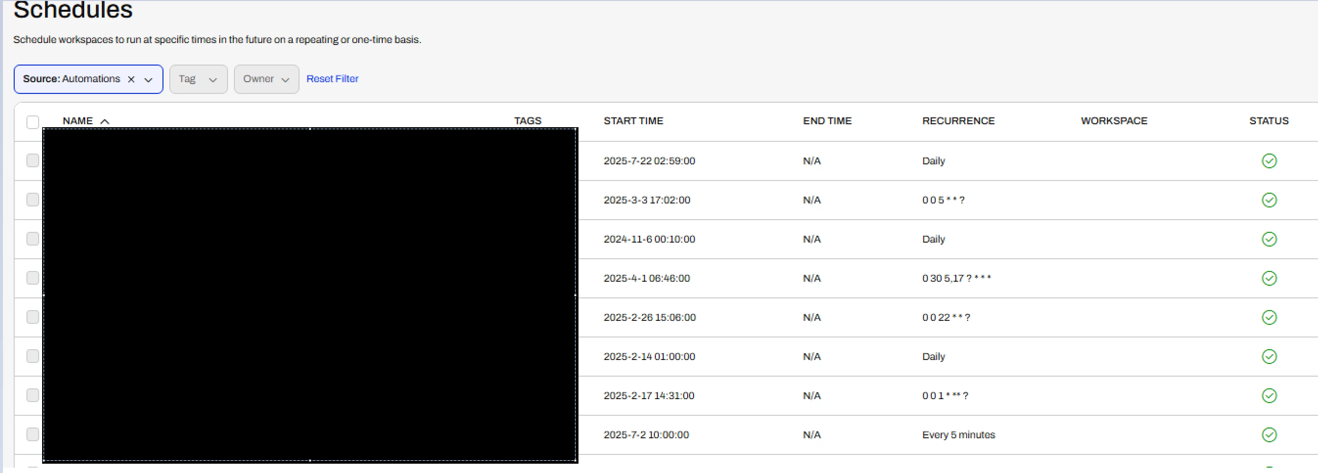

I’ve tried reviewing results from /schedules. This doesn’t seem to include our schedule triggers in automations.Neither /automations or /automations/{id} return the required information.
Can anyone point me in the right direction?
Thanks!
AW
Best answer by ebygomm
What version of FME Flow?
In 2025 you can go to schedules and then switch the source to Automations
You can also get details via the rest api
FMEURL/fmeapiv4/schedules?limit=100&offset=0&sourceType=automation
or
FMEURL/fmerest/v3/schedules?includeAutomations=true&limit=-1&offset=-1
depending on version

  • Mar 23, 2026 8:22 AM UTC
The same menu is present in 2024 (i wasn’t sure without checking), however i think the API call is more useful as Automations that are triggered by basic schedules just give you the detail of e.g. Once a day without any indication of what time of day that is.
