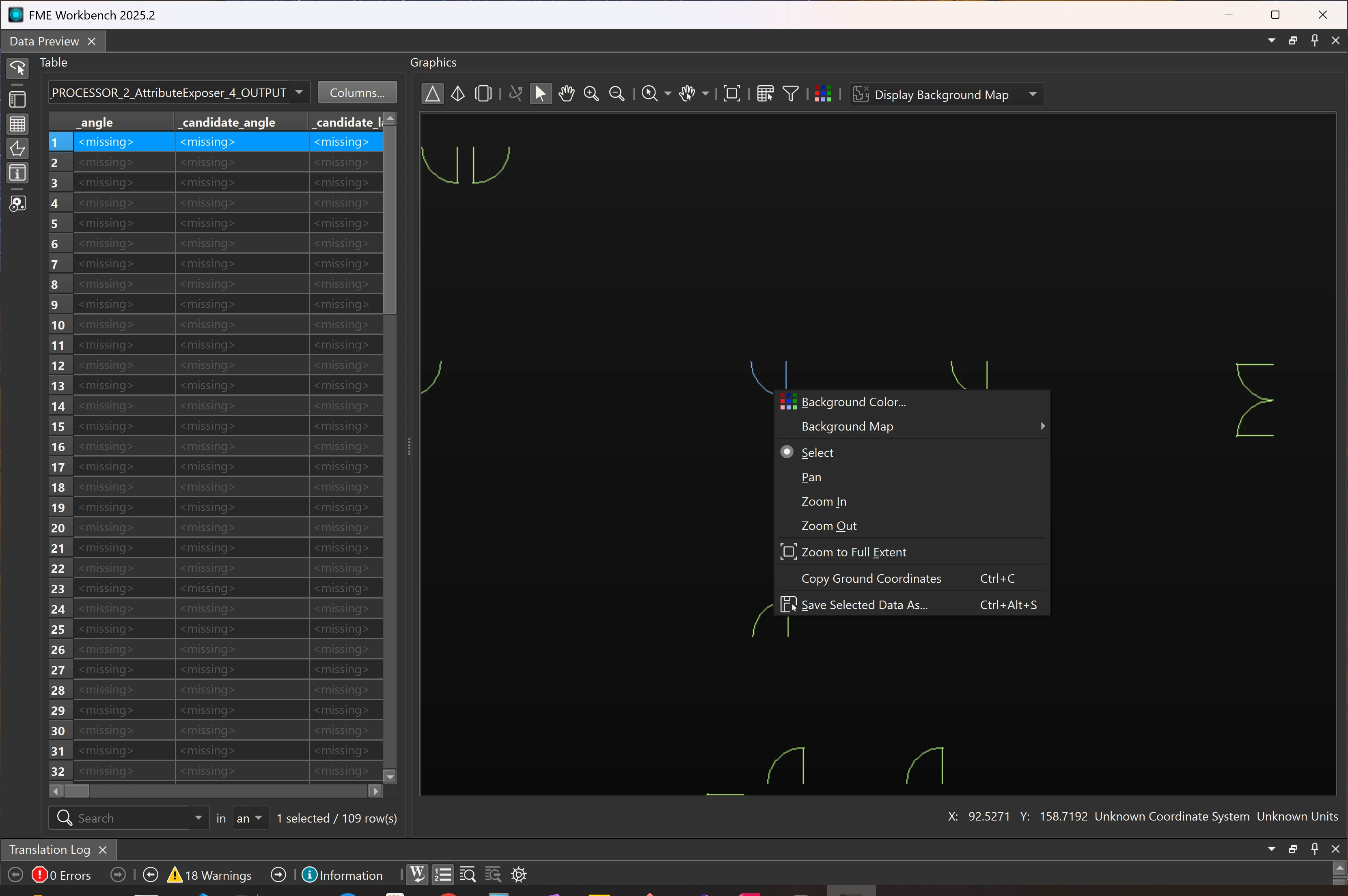

I used to be able to right-click in the Data Preview and get the ‘Zoom to Selected Feature’ for the CAD geometry.  The last few versions of FME have not had that available.  What gives?
Please see the attached.
Currently using the latest build:  FME(R) 2025.2.2.0 (20260106 - Build 25827 - WIN64)

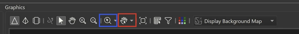

The Zoom To (blue) and Pan To (red) buttons are still in the task bar. They’ll Zoom/Pan to the selected feature

Oh ok, I didn’t notice!  I’m more of context menu person.  At least it exists somewhere.
Thanks!
