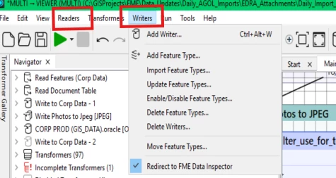

What happened to the reader and writer drop down menus in FME 2025.2? Why would they remove them? Am I just missing how to add them back in? So frustrating.

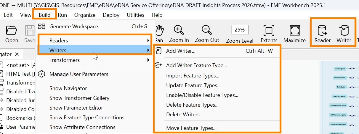

These were moved to the Build drop-down.  Additionally their icons are still also in the ribbon.
This is from 2025.1:

Hi ​@mel thanks for asking this. I can understand the frustration of things not being where you expect after an upgrade.
To answer your question (chriswilson got it right): The Reader and Writer menus weren't removed, they were moved to the Build menu as part of a menu redesign released in FME 2025.1. Here are some resources that walk through this and other changes:
Additionally, in 2025.1+ there's a new Add button directly on the canvas that lets you insert Sources (anything able to read data in to a workspace), Destinations (anything to write data out), and Transformers — which is another quick way to add readers/writers beyond the buttons on the toolbar highlighted in the screenshot above, or just typing to search on canvas through the Quick Add.
I've moved this from Ideas into Forums since it's a question about the current UI. If after trying the Build menu or other options you still feel something could work better, we'd welcome a new Idea post with specific suggestion on what you are looking for.
