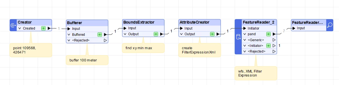

If I use FME 2025.2.1 it just works as expected.
WFS url: https://service.pdok.nl/kadaster/bag/wfs/v2_0
XML Filter expression:
<fes:Filter
    xmlns:fes="http://www.opengis.net/fes/2.0"
    xmlns:gml="http://www.opengis.net/gml/3.2">
  <fes:BBOX>
        <gml:Envelope srsName="urn:ogc:def:crs:EPSG::28992">
          <gml:lowerCorner>109468 426371</gml:lowerCorner>
          <gml:upperCorner>109668 426571</gml:upperCorner>
       </gml:Envelope>
   </fes:BBOX>
</fes:Filter>
Returns 7 features as expected.
