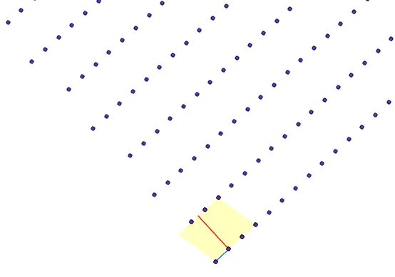

Points in 2D - the blue line is 20m; red is 50m (perpendicular to the rows); the pale yellow area is what I’m using for my tests (the dataset has about 1.8m points in total)

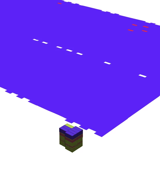

Points in 3D

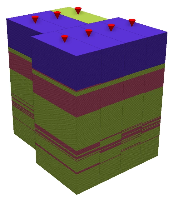

Mockup with point symbology - desired result
