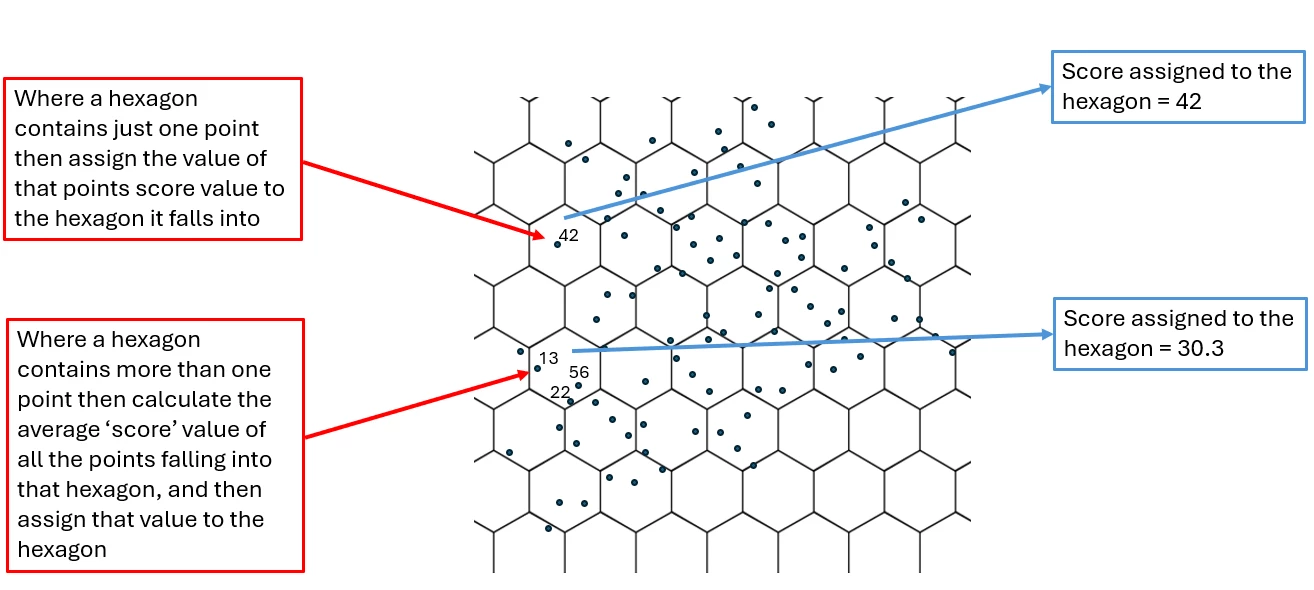

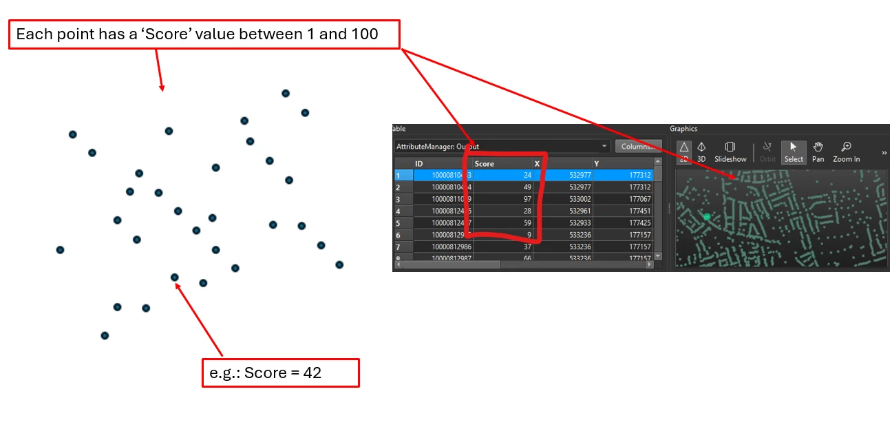

I have point dataset with 5600 points at an address level. Each point has a ‘score’ value of between 1 and 100.
I need to create a hexagon grid. And then assign to each hexagon the score value of the point, or the average score values of the points, that fall into each hexagon.
If only one point record falls into a hexagon, say with a score of 42, then that hexagon will inherit a score of 42. But if several points fall into a hexagon, say with scores of 13, 56 and 22, then assign the average value of 30.3 to the hexagon they fall into.
I also need to define the size of the hexagons/hexagon grid.
