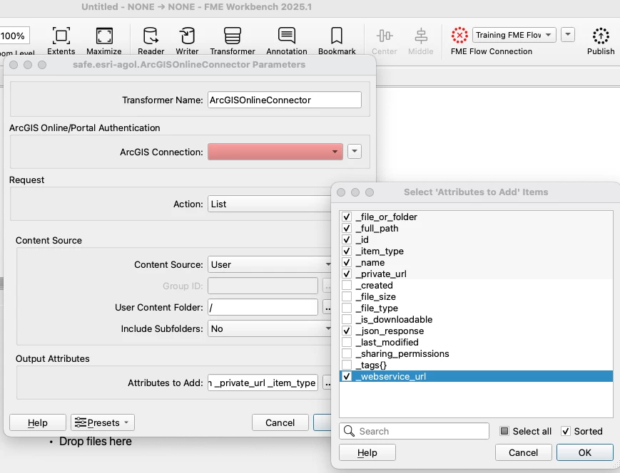

I wonder if there’s a way for me to hack the web connection during run time to expose the AGOL Organization URL and token so I can use this URL downstream.
The ArcGISOnline Connector returns these as format attributes but I have the extra overhead of running the right action item to expose them.

Have you ticked on other output attributes from the AGOLConnector
Yes, but you get the overhead of running an Action Item like List, that will produce a feature that has more attributes than you need.
