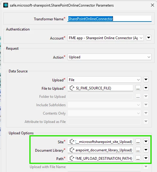

I would like to embed a SharePointOnlineConnector in a custom transformer but I don’t want to hard-code the Site, Document Library and Path values. However, when I create User Parameters to expose these as custom transformer parameters I am not able to actually select values for them. I have also tried creating User Parameters for these values as input parameters for a SharePointOnlineConnector in the main workspace but run into the same issue.
This is how my SharePointOnlineConnector is configured (I have used all default values when creating the User Parameters):

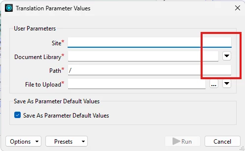

This is how the parameters look when I try to run the workspace (or edit them in my custom transformer settings). Note that there’s no way of actually selecting values:
