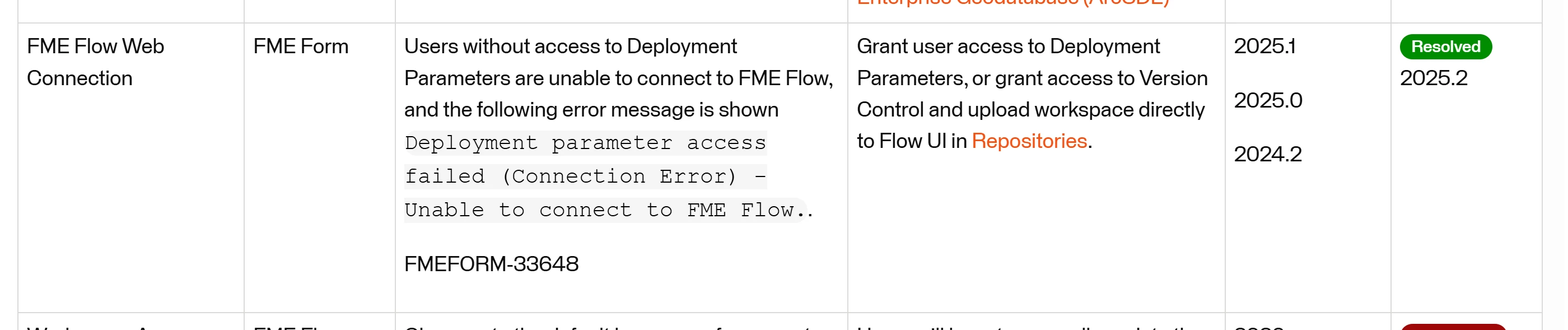

Hi ​@anryan,
Can you please confirm you’re not encountering the following known issue? It should be have been fixed but it would be good to double check:
Assuming this isn’t the problem, I had a look for your support ticket but I can’t find it in our system - could you please send your 5-digit ticket number? Feel free to do this here or over DM.
