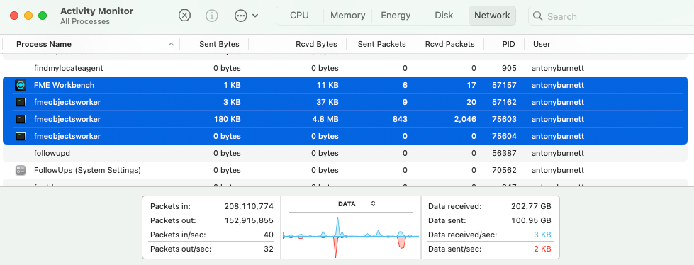

Here is a view of network traffic on my machine with a map at the town level. Not much happening.

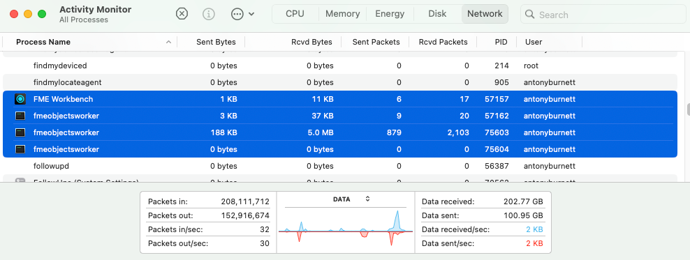

But look what happens when I then Zoom to Extents so the maps scales to all of Australia. Look at the spike in network traffic - some 6MB to draw a map?
From what I can estimate FME is requesting hundreds and possibly thousands of map tiles for any given zoom request.
What happens next is that OSM will either block or possibly throttle my IP for a period of time.
Mapbox seems to perform better, but looking at my stats I’m churning through quota. Possibly when I hit the included quota I’ll get throttled or billed, neither of which is that appealing.
My understanding of XYZ tiles is that you need the same number of tiles at ANY zoom level. The number of tiles should be around 20-30 per map window depending on the shape (square or elongated rectangle). That’s the visible tiles, plus the edge tiles, plus maybe one more row and column of tiles off screen ready for panning.
But FME is requesting about 6MB which works out to be 500 to 1000 tiles for Australia-level zoom.

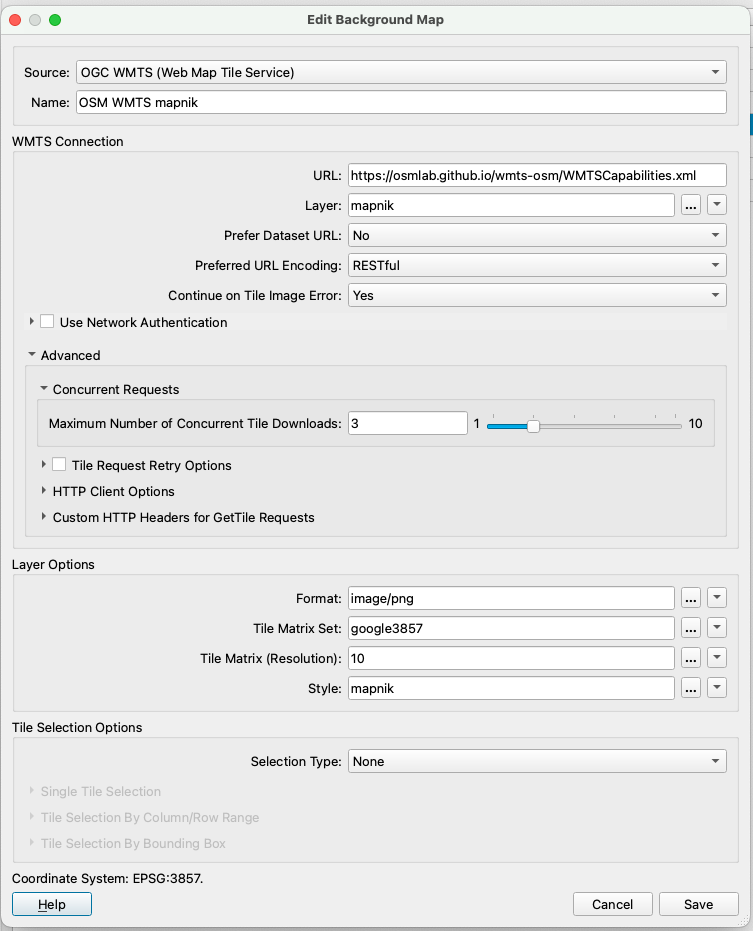

So going to “Tiled Web Map XYZ” is not the recommended method of consuming OSM tiles? I added a WMTS server (https://osmlab.github.io/wmts-osm/WMTSCapabilities.xml), in this case a repo on Github, and the maps are loading super fast now. I think.
Before:
Before
and a country-level zoom:
After zooming to country level
About 200kb instead of the previous 6-8MB!
I will use this and test further. Thank you, ​@j.botterill
Configuration for WMTS OSM map tiles, via https://osmlab.github.io/wmts-osm/WMTSCapabilities.xml
