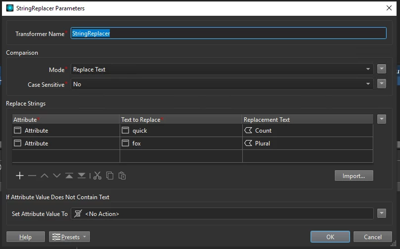

When you say you’ve tried in 2026, do you mean with the StringReplacer which now can handle pair replacement and will also allow you to use an attribute as replacement text?

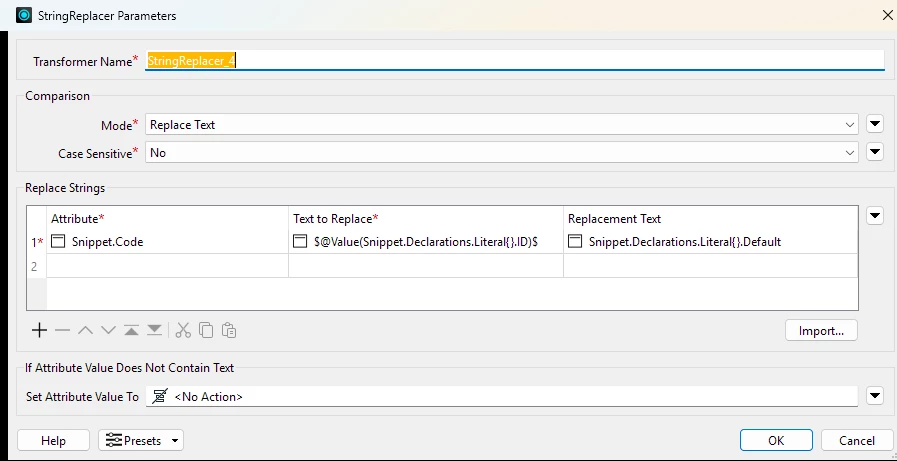

I built the workspace in v2020, and opened it in v2026 and updated the transformer before writing here. Nothing changed in the result doing this.
This updated StringReplacer isn’t really useful to me.

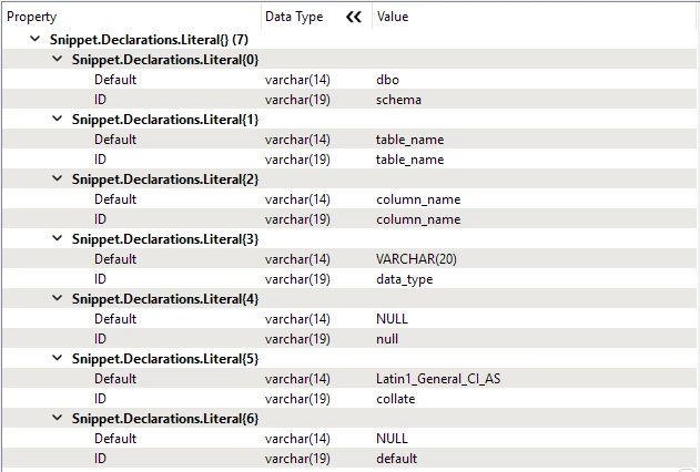

I have the replacement tags and values in a list with an ID and a Default qualifier, and I need to apply all (variable number) of list entries to the target text all at once. Like in the image below. However, this setup doesn’t work.That’s why the StringPairReplacer was the better choice, but without much success.
