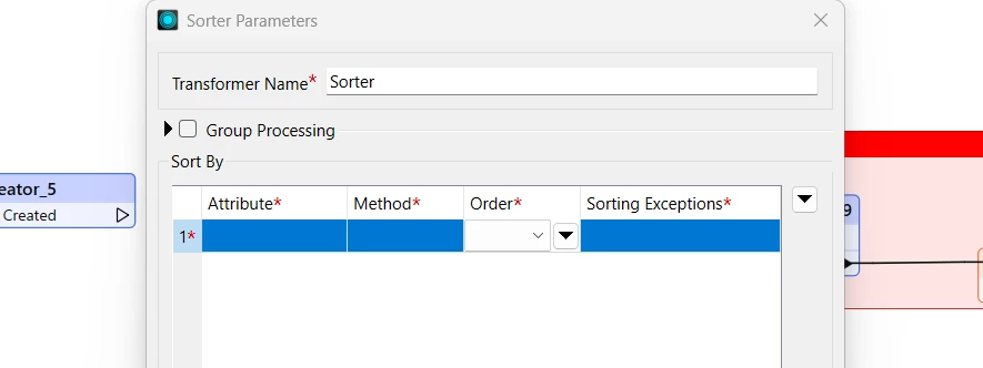

Hi ​@lifalin2016 ,
I suggest you to use the transformer Sorter. In this transformer you can choose the Attribute, Method ( Natural, Alphabetic, Numeric) and Order.
