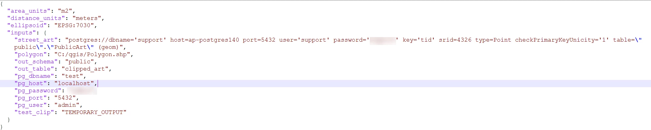

While I'm not completely familiar with using QGIS Modeller with FME, I did have some success running it with the system caller. Here is the approach I used:
The model is simply reading in a pg point layer and clipping it with a polygon. The output is exported to another database.
Instead of using Copy as qgis_process command, I used copy as JSON to store the parameters.
I had to make one change to the copied JSON before it would run: adding user='...' and password='...' to the postgres connection string. The copied version doesn't include them (QGIS fills them in from the saved connection when you run in the app), and without them qgis_process failed with "Incorrect parameter value" on that input. I suspect this may be related to the "File could not be found" error you're seeing, since QGIS can't resolve the connection string without credentials. I also used full paths for any file inputs, since there's no open project for QGIS to resolve relative paths against.
For the actual command, I used:
"type "C:\qgis\test1b_model_postgis.json" | "C:\OSGeo4W\bin\qgis_process-qgis.bat" run "C:\Users\dylan.paterson_safe\AppData\Roaming\QGIS\QGIS3\profiles\default\processing\models\model.model3" - --verbose > "C:\qgis\out_fme.txt" 2>&1"
which created the table in the database.
