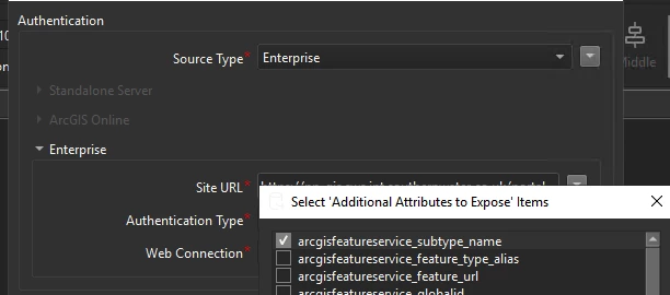

I am in the following situation: I need to read subtype domains from an ESRI enterprise geodatabase, and I would like to see the domain descriptions, not just the codes. I’ve tried using the new ‘feature service’ reader (enterprise configuration) and enabled domain resolution and exposing subtype_name, but I didn’t get the expected result.

Did you expose arcgisfeatureservice_subtype_name?
giulianexus
Forum|alt.badge.img+6
  • April 8, 2026
Hi ​@ebygomm !!Yes,as wroted in the comment.. and still nothing...

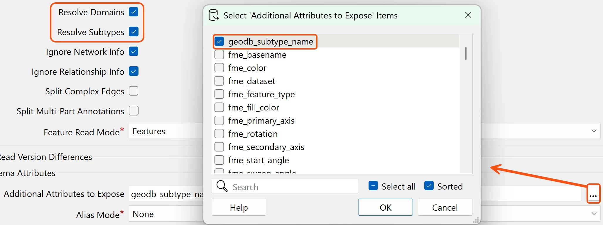

If you are reading directly from an enterprise geodatabase, you would use the ArcSDE Geodatabase Reader. This reader includes both Resolve Domains and Resolve Subtypes parameters and you can manually expose the format attribute geodb_subtype_name if you need the subtype label itself exposed in the workspace.

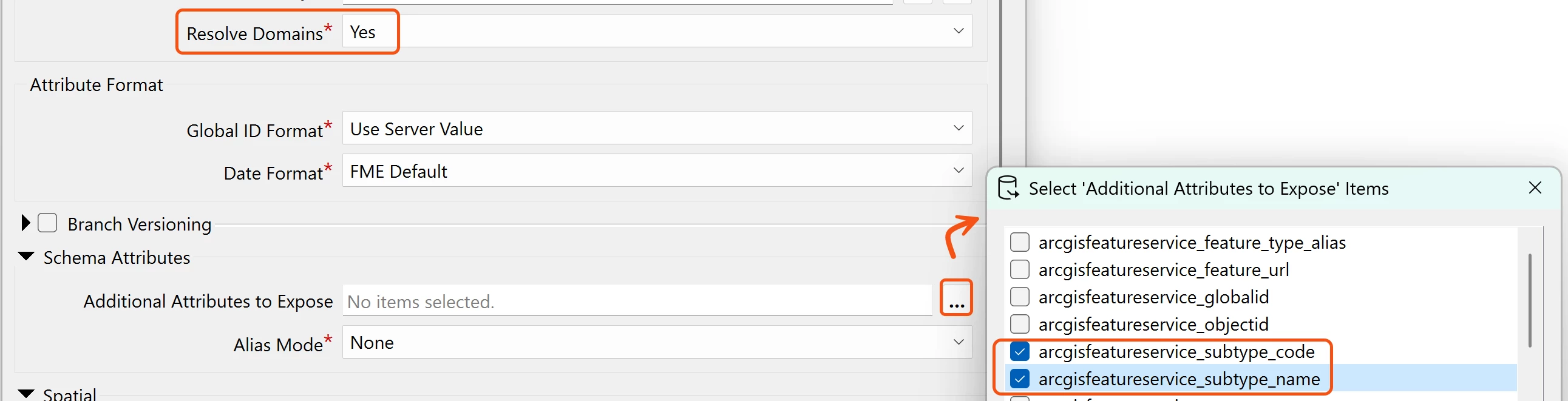

If you are reading the data through an ArcGIS Enterprise feature service, use the Esri ArcGIS Feature Service Reader. That reader includes the Resolve Domains parameter and the documentation notes that coded domains defined within subtypes are supported. The subtype itself can be exposed through the format attributes arcgisfeatureservice_subtype_code and arcgisfeatureservice_subtype_name.
