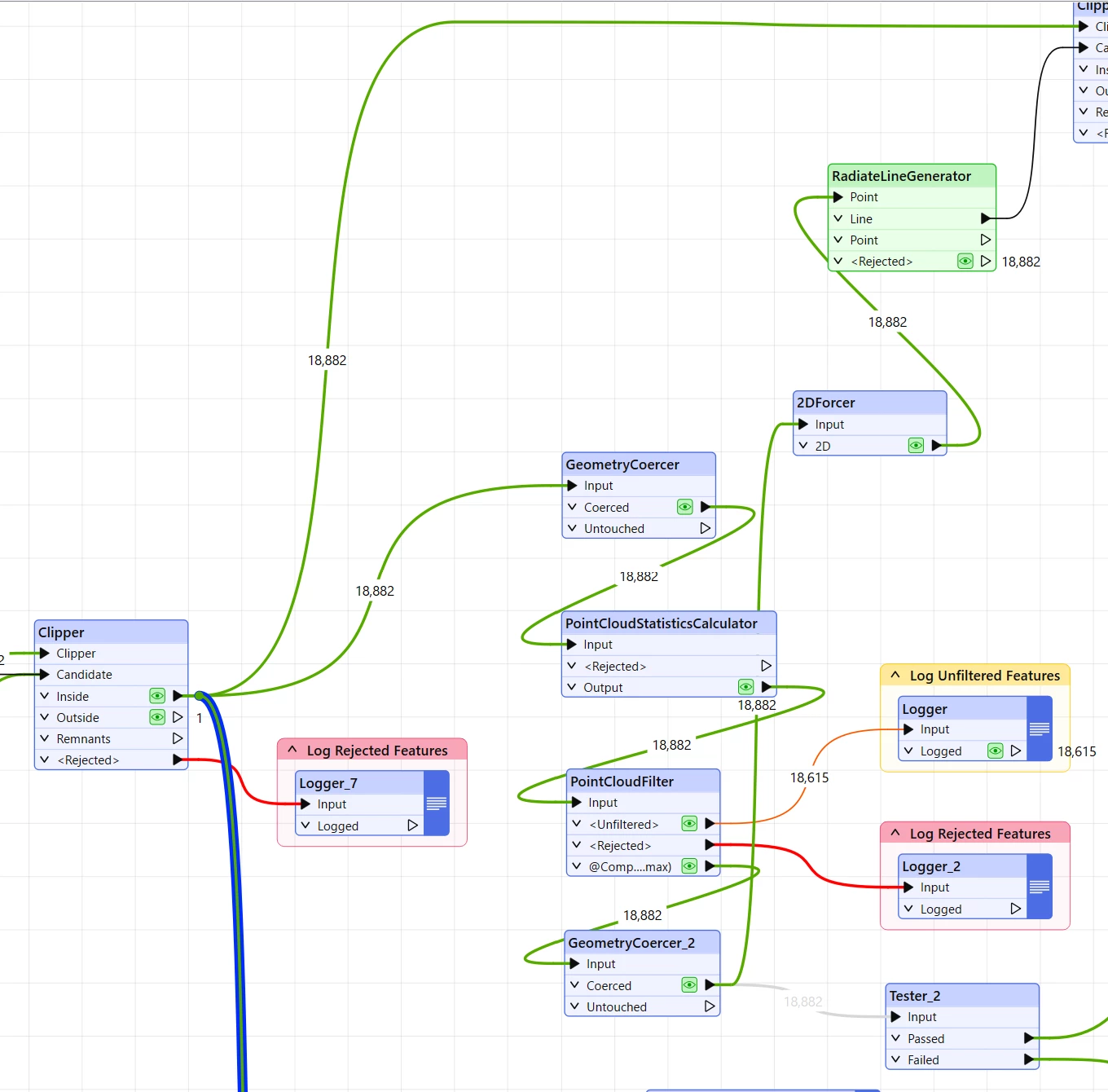

I have a workbench which takes a dem raster and clips it at various points, it converts the raster clips to the point cloud and extracts the highest value for each segment.  i then want to be able to use the highest point with the radiate line generator to show additional lines before being clipped and calculated.  I have tried a 2dforcer, aggregator and others to get the Radiate Line Generator to work, but it fails every time.. any idea how to get points from the workflow, and what have i missed..??
If i try the Radiate Line Generator with a ‘normal’ point dataset then everything works fine and as expected..

We aren't as familiar with the RadiateLineGenerator, as it is a Community Transformer but it might not support point cloud or multipoint input.
Is the GeometryCoercer_2 converting point clouds to multipoints? You could try using a PointCloudToPointCoercer instead with Output Geometry set to Individual Points.
Please let me know if that helps!
