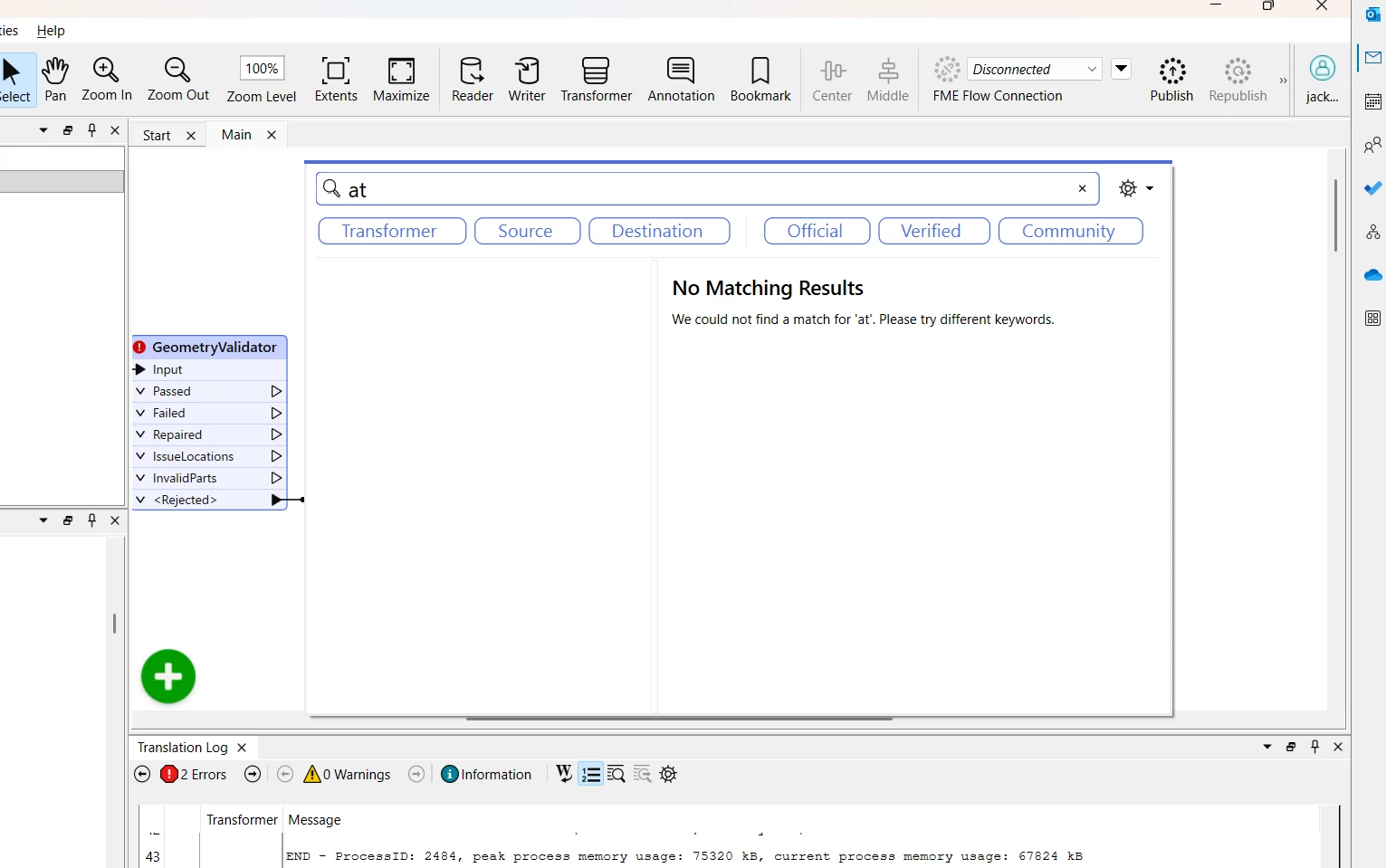

Hi, has anyone encountered this issue with 2025.1? Or am I doing something wrong?

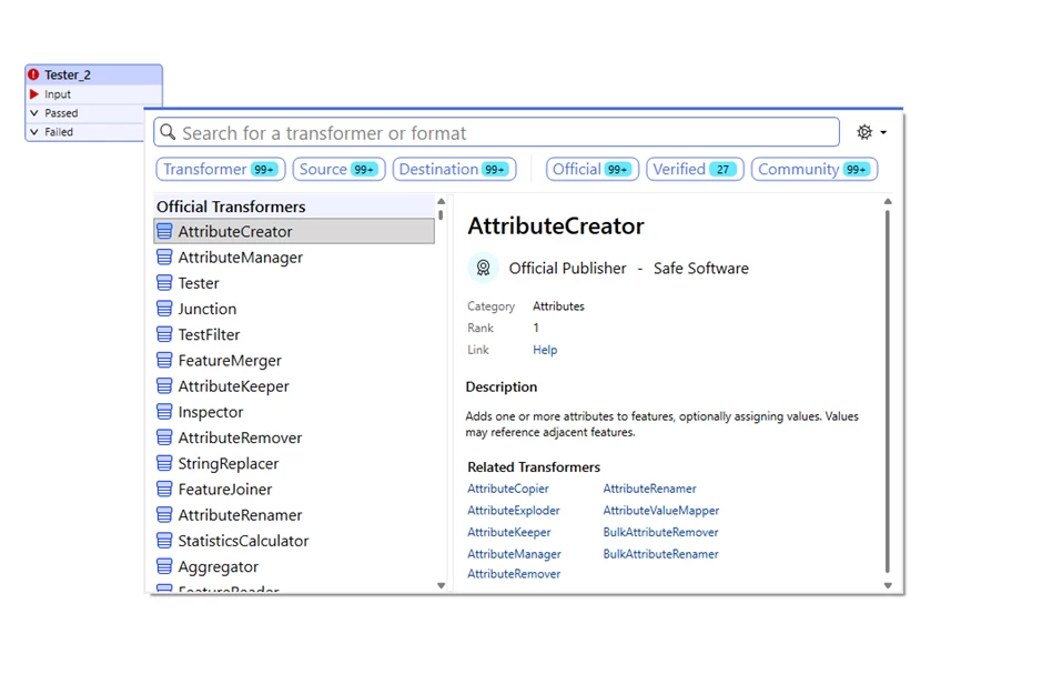

I’ve seen some odd behaviour with Quick Add in some of the recent versions as well. In 2025.2 it seems mostly back to normal, and the issue you’re seeing appears to be fixed in that release.
If you’re able to upgrade, it should solve the problem.
I’ve seen it intermittently in 2025.1, it seems to sort itself out if i click the add transformer button on the toolbar
