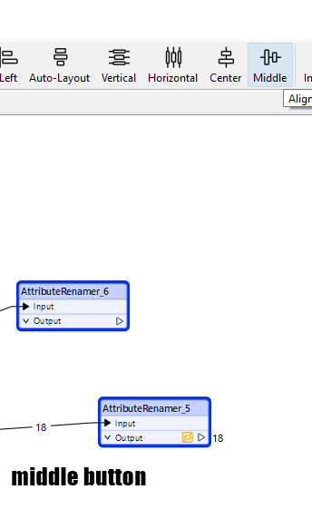

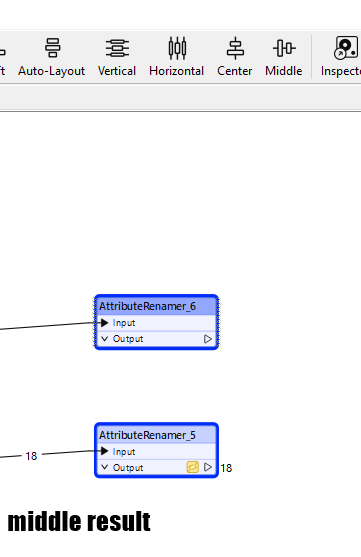

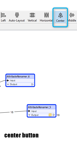

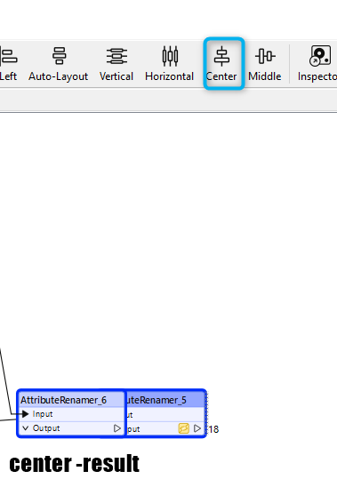

When I use the button “alignment Middle” the alignment is vertical and when I use the button “alignment center” the alignment is horizontal. The action seems to be the opposite of the picture on the button.
Do you have the same thing? On FME 2018 is the reverse and it look more logical.

Hi! Yes, this is a known issue in 2024.0. I believe it’s fixed in 2024.1
Apologies for the inconvenience. It sure caused me to look twice when I first encountered it.
