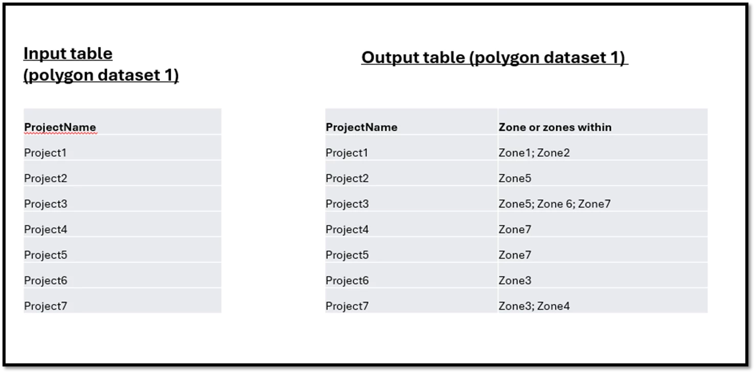

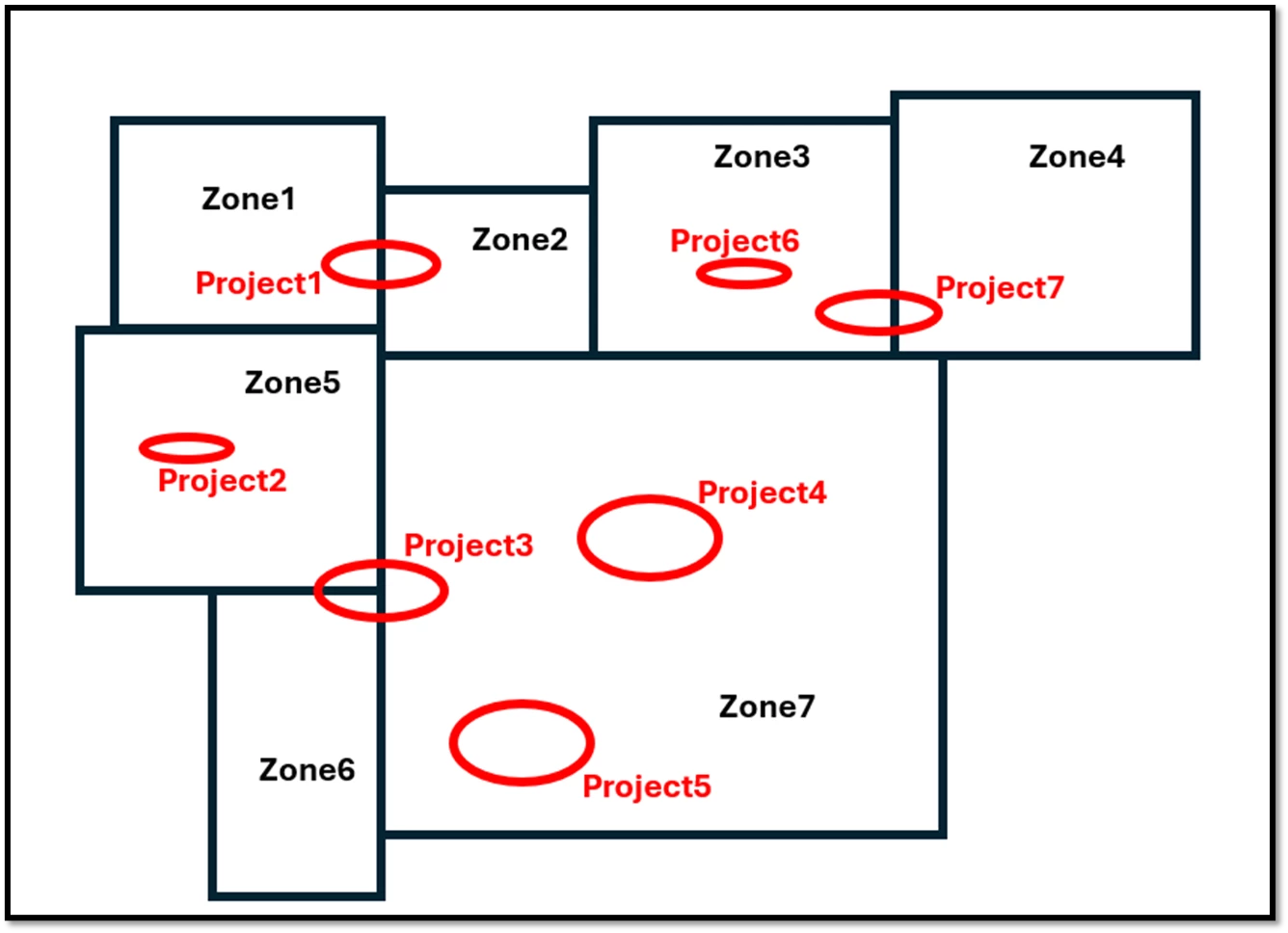

I need to run a polygon-in-polygon attribute update process. I would normally use the AreaOnAreaOverlayer transformer for this where I know that features from the first polygon dataset are all fully within any individual feature from the second polygon dataset.
But I now have a dataset where any feature from polygon dataset 1 could be… a) fully within a given polygon from polygon dataset 2, b) straddling between two or more polygons from the other polygon dataset.
This is what I need…
If a feature from polygon dataset 1 is fully within a feature from polygon dataset 2 then populate a new attribute with the value of the feature from polygon dataset 2
If a feature from polygon dataset 1 is partially within two features from polygon dataset 2 then populate a new attribute with the values of the two features from polygon dataset 2.
These diagrams explain it further….
Is this possible in FME Form?

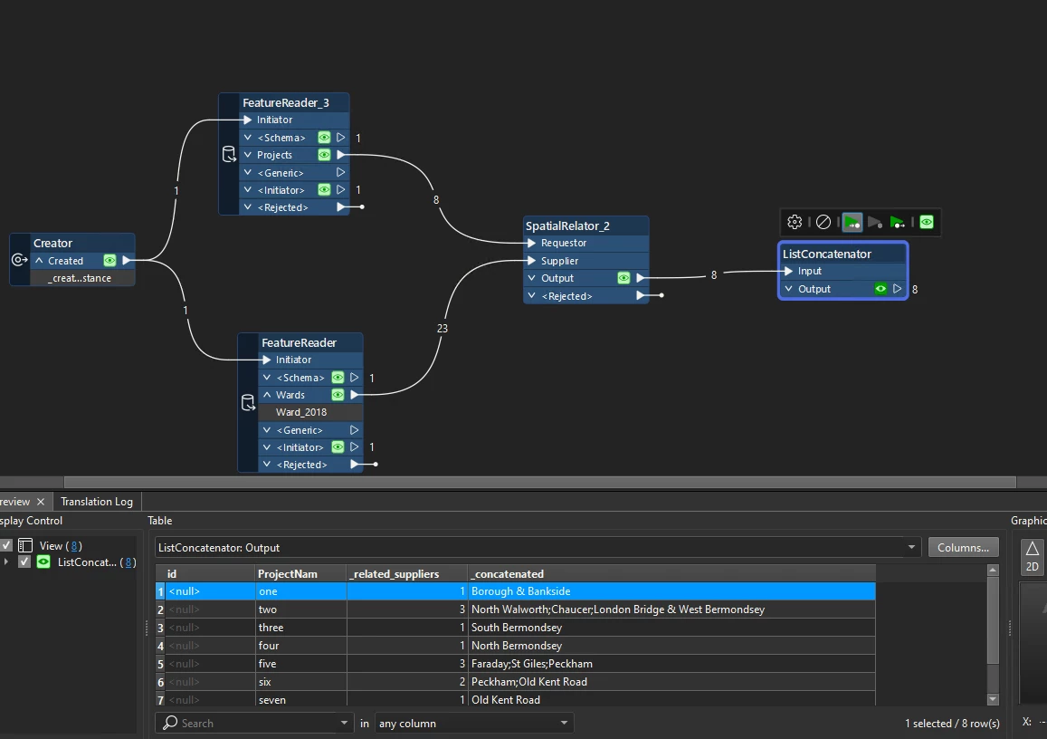

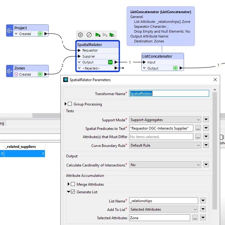

You should be able to do this with a spatial relator, build a list of related suppliers then concatenate the list
scarter
Forum|alt.badge.img+10
  • Feb 24, 2026 4:23 PM UTC
Thanks for that, ​@ebygomm. It took a while, but I got there. Thank you.
