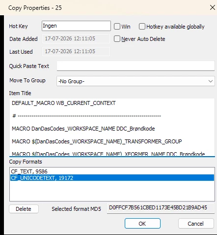

I can copy a transformer from FME Form, and paste it right back. I can also paste the definition into a text editor, as the copied content is just text (FME file syntax).
But when I just copy the complete transformer (without changes) back from the text editor (Ctrl-A,Ctrl-C), FME Form will not paste it into the workspace.
I used Ditto clipboard to look for differencies, and I can barely find any. The two attached images shows the properties for the original and the text editor copy.
original from FME Form
text editor copy
The only difference I can find are the slightly different counts for CF_TEXT. The counts for CF_UNICODETEXT are identical.

What you're running into is a known limitation rather than something specific to your transformer. Workbench only recognizes pasted content as a transformer when it comes from inside another Workbench canvas, either the same workspace or a different open workspace. Once the definition passes through a plain text editor, even completely unchanged, the operating system rebuilds the clipboard data itself instead of carrying over the exact object FME originally wrote to it. That is almost certainly why Ditto showed a different CF_TEXT byte count for the round-tripped copy while CF_UNICODETEXT stayed identical, the readable text matches but the clipboard packaging Workbench checks for does not.

I found a workaround with help from Claude.
It seems that Workbench copies not only the old mapping file format as regular text onto the clipboard, but also newer XML formatted text to other parts of the clipboard. Workbench only reads the latter, and this is not created by a text editor, only by Workbench
I had Claude build me a small Python script, that automatically copies the XML formatted text between these two locations in the clipboard, and now I can copy a transformer, edit it, and paste it back with changes into Workbench.
