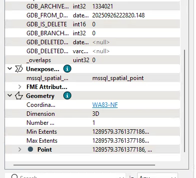

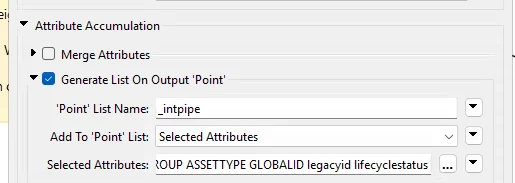

I have an odd problem. I have suddenly lost the ability to view the lists on my objects in the “feature information” pane. They are indeed there, I can search and explode them, but for some reason -mid working on this workbench- I have suddenly lost the ability to see my lists.
I am in version 2024.2. I havent found anything helpful or related online yet so thank you if anyone is able to assist.
created list ^
no list visible ^
I am ONLY able to see the lists in the “Found” port of a list searcher, but in NO other occasions can I see them.
