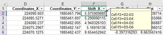

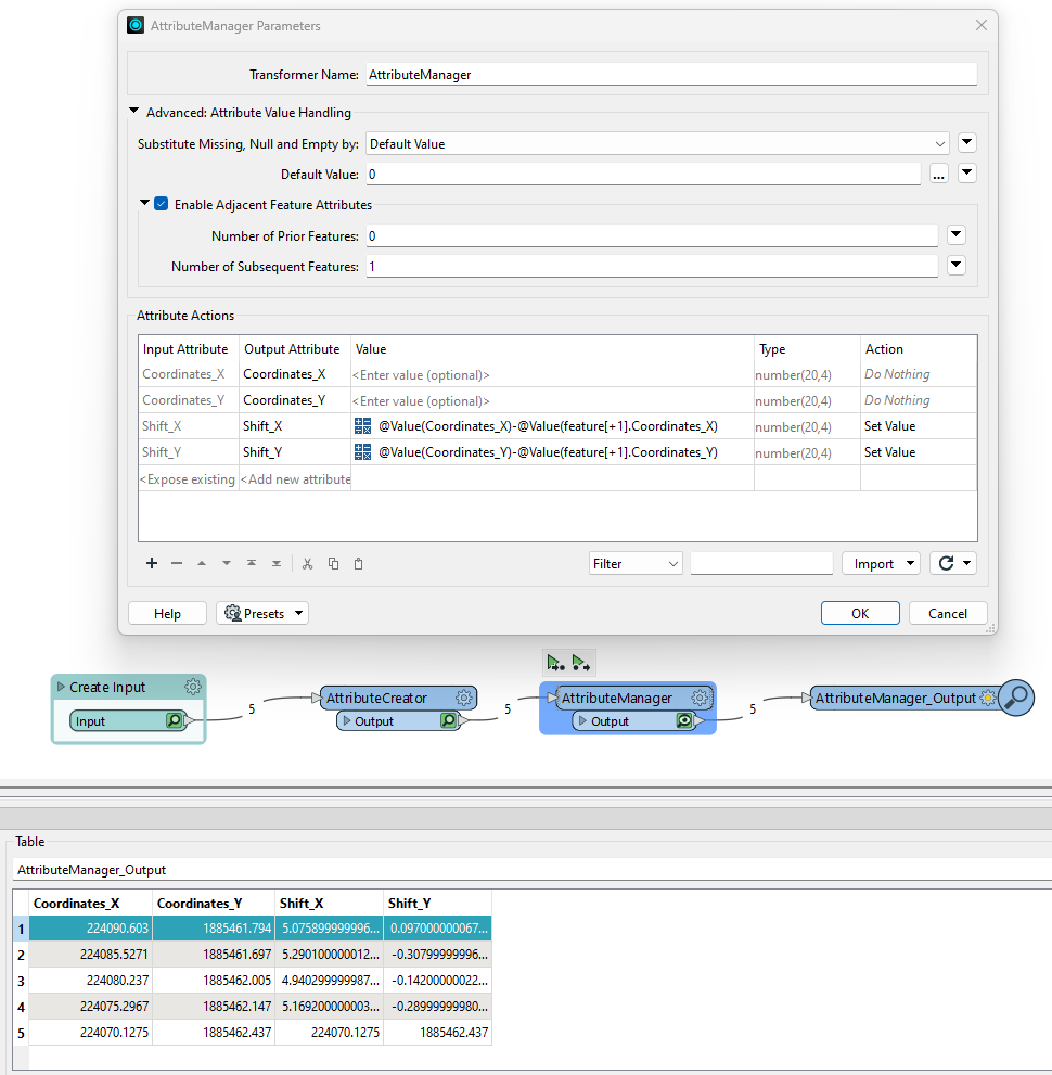

Something like this:
Note that for the last feature it will just copy the values of the attributes Coordinates_X and Coordinates_Y.
More information in the Documentation (under Advanced Example).
