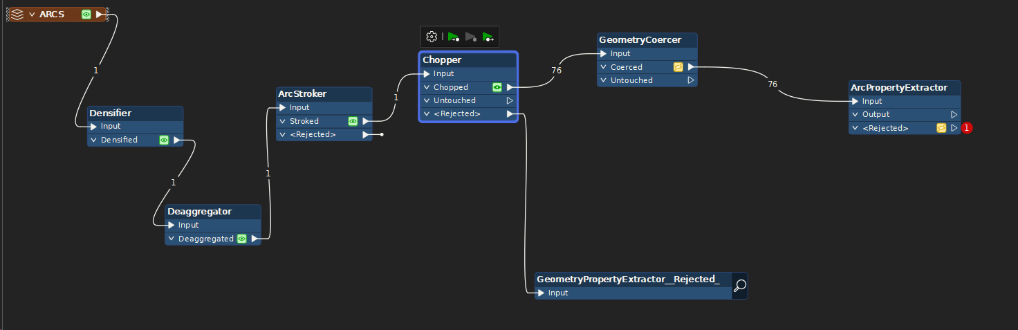

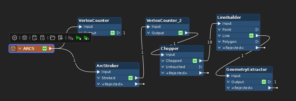

Hi ​@juliarozema I tried multiple ways of splitting, reading and rebuilding the line but I see no arc. Linestring on read and on out. In the example you provided (thanks for providing!!) I could not see an arc. But this still fails or SDE? In the process of being written to SDE is there a writer that is defining these as Arc?

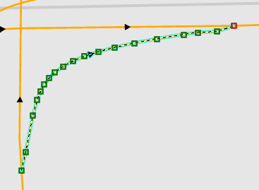

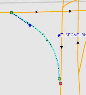

Using the sample feature from my first post, when I go into ArcGIS Pro and select “Edit Vertices” I see the node-handle bar things that are used to adjust an Arc (see image).
ArcPro | Edit Vertices | Blue node-handles for adjusting an Arc shows up on sample feature.
For road segments without an Arc, usually I only see vertices.
ArcPro | Edit Vertices | Just vertices shows up on a regular road segment.
Might this sample Road Segment that seems like an Arc, be classified as something other than an Arc?
And, how can we use FME to test for it?

The Road Segment has a spline geometry, which is another type of curve. FME does not support spline geometry, so the reader is automatically stroking it to linestring that closely follows the spline path. This is generally sufficient for working with the data, but there is no way to distinguish a stroked spline from a regular polyline.

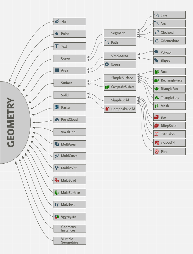

here is the FME geometry model that helps understand the fme supported geometries
https://docs.safe.com/fme/html/FME-Form-Documentation/FME-ReadersWriters/!FME_Geometry/FME_Geometry_Model.htm
