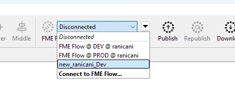

Does anyone know how to delete an FME Flow connection in FME Form 2025+?
FME Flow connections used to be configured in the FME Options dialog under the Web Connections tab but they are no longer there in FME 2025. Instead, they are now available from the main FME Form toolbar.
Using the toolbar I can create a new connection, select and edit an existing connection, but I don’t see any option to delete an existing connection. Even the FME Form documentation does not provide any help.

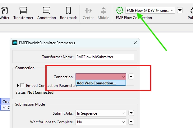

I think you’ve found a bug!
I’m guessing your Connection Storage (under FME Options - Default Paths) is set to FME Flow?
When I set mine to FME Flow I can still see FME Flow connections that are present in my Personal Database, but only in the FME Flow Connection box! When I look for connections in a transformer, I can’t see any of the ones present in the Flow Connection drop down

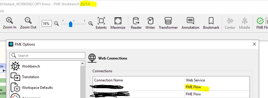

Tools > FME Options > Web connections > Rclick > Remove
That is very interesting… I didn’t take the time to read your reply fully but now realise that you’re correct, I don’t have access to any FME Flow connections in the FMEFlowJobSubmitter either, even though they are defined in the toolbar connection widget.

That is strange because I have them in
As mentioned in my post, there are no FME Flow web connections listed under Tools > FME Options > Web Connections. In FME 2025 management of FME Flow web connections has been moved to the widget on the toolbar but the toolbar widget doesn’t provide any option to delete an existing connection.
2025.0 has it in FMe Options so that is strange..

​@50098  there were significant changes made between 2025.0 and 2025.1. To me it’s way more than just a .1 release and more akin to a full version release but I guess Safe wanted to keep some things back from the .0 release so they’d have something to show at the UC, or maybe development just wasn’t quite stable enough to make it into the .0 release.
